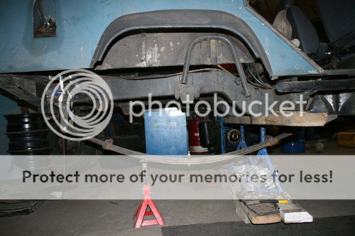

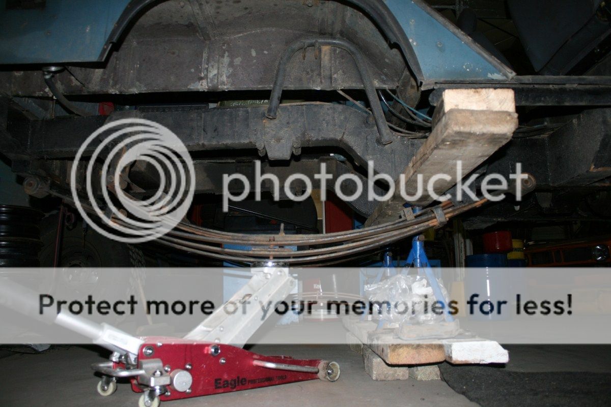

Ok, here we go..
Basically, I wanted a comfortable suspension setup, that flexes a lot, but can still carry a load (mainly camping gear really). And I wanted to keep leafsprings. So I opted for rear springs at the front, parabolics as they are more comfortable. The frame was extended 6" with new spring mounts, and the shackle bush was pushed back more or less the same amount.
I used to run 3leaf parabolic rear springs but they were too soft. I didn't want to add another leaf as it would lift the back end up and the driveshaft was already making quite a steep angle. So I decided to start fresh and mounted 63" chevy springs (with RuffStuff brackets). The axle has been pushed back 2" at the same time. The springpads were redone so I could run a double cardan driveshaft. The springs have also been inboarded slightly compared to a standard 109". Mainly as this was easier to fit the brackets to the frame. End result is slightly less stability and slightly more flex.
Obviously the brakelines are extended. I welded hoops to the frame to act as top shock mount for the 14" stroke Bilstein 5125's. Very nice shock by the way..
Steering wise I bought, out of the first batch made, a pair of highsteer knuckles and arms from Hellfire Fabworks, for the 80series LC front axle. This raises the steering rods above the leafsprings and in front of the axle. Expensive but very nice bit of kit.
The leafsprings all sit fairly flat, not much arch in them, but that keeps the vehicle relatively low. Which is good. I haven't had much weight in it yet but it seems to be able to handle in. It's comfortable but as is has a low CoG it corners very well for a sprung over vehicle. And plenty of articulation.
Here are some pics..
Mount for P38 steering box... Only fabwork needed, the rest is all bolt on..
