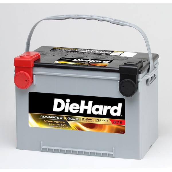

EDIT: As an alternative there does appear to be a Deka/Sears 78 AGM Battery.
Deka 9A78DT - http://www.lowrangeoffroad.com/deka...-and-side-post-10-3-4-x-6-7-8-x-8-9a78dt.html
Sears DieHard Advanced Gold 50778 - http://www.sears.com/diehard-advanc...p-02850778000P?prdNo=8&blockNo=8&blockType=G8

There are several other batteries at O'reilly that look exactly like that except for the sticker which makes me wonder if that's what they are.
If the O'Reilly batteries have the same specs/dimensions as the Deka batteries I'd say they probably are the same units.
