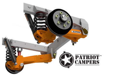

Hi John, The Suspension and the hitch were purchased from Cruisemaster. It is the same suspension used on the Patriot Trailers. Not cheap but quite robust.
So this, Aussie line?
"This system is not available outside of the Patriot Campers range of products"

Yes, except those are the airbag version, I got the shock versions. I got it thru Sloop Imports in Steamboat Springs CO... about $3k and includes everything except the wheels...
