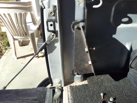

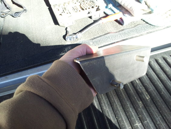

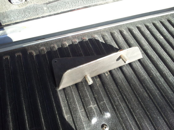

Came up with this bracket to start with.
It mounts where the bolts run thru the body to mount the taillights, first gens mount the tailgate extender here. No plans to put an extender back in the truck .

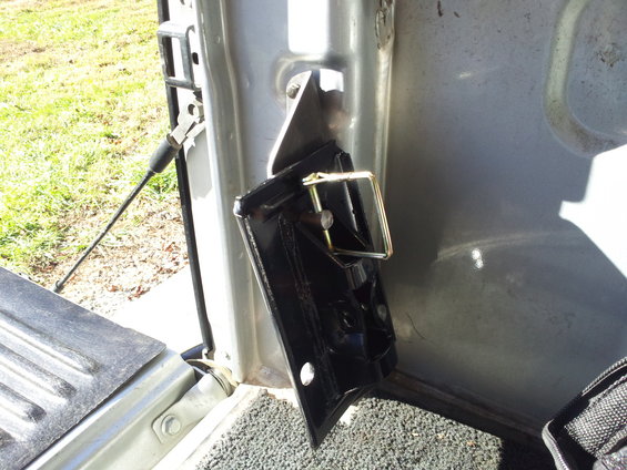

The bracket has two dowels to locate and hold the base of the hi-lift. I drilled one of the dowels to use a spring pin to hold the base on the bracket.

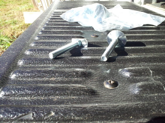

I started by picking up some "elevator" bolts. I cut/ground two sides of the elevator bolt so it would slide into the super track.
Once I slid the elevator bolt into the super track, I used a leftover shock absorber washer and a nut to lock it down. Then I double nutted a fender washer onto the stud. Next slide the hi-lift over the stud, up against the fender washer, another fender washer and a wing nut to lock it down.
She's mounted.
I am very pleased with the mock up. As you can see it needs to be disassembled and painted. But before paint i need to weld on some spacers to the back of the lower mounting plate. If you look closely you can see the recess in the body where the bolt holes are. I stuck some washers behind the bracket for mock up , but I would like it better with some spacers tack welded to the back of the bracket.
