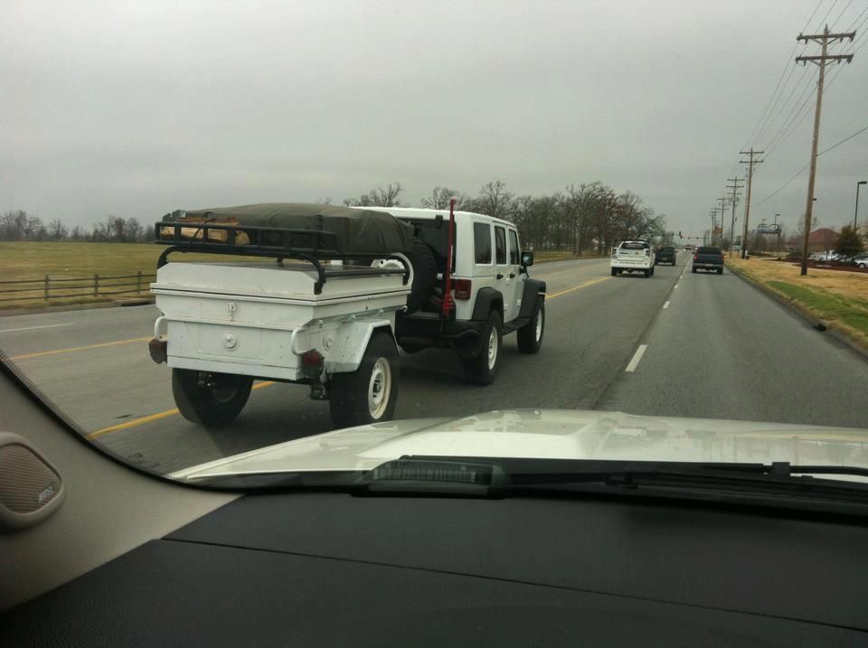

Lid and Rack are "Done" for now.
In an effort to avoid metal rubbing metal I used rubber isolation bushings between the basket and roof rack as well as the tent.
To attach the fire wood rack I installed blind nuts to the bottom of the tube prior to powder coating. I had planned on trough bolting it but wanted to prevent any water from making its way into the tubes from the top.

Someone snapped this picture of James with this rig behind his JK this past weekend. Looks Awesome behind the truck!
Good on you James! The top and rack are super!

A few weeks ago we spent the weekend camping in the Ozarks. It was a good test run for Pepe. A couple issues I will need to address.
1) The wheels rub the fenders. I suspected they would. New fenders just got moved to the top of my list.
2) With the fire wood loaded on the top I need to adjust my gas assist springs to do a little more assisting. Fortunately I purchased an extra set of mounting brackets just in case.
Here is a pic of us on our way to camp.
