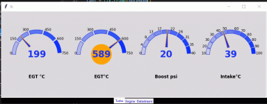

The biggest question I had was whether I could build a digital dash that updated in real time, and showed the graphs with useful data. Here is where it is a presently - the dials move around randomly because I have a sensor emulator running that simply generates random numbers.
Daytime Screen:
Night time screen (I know the numbers and dial don't match on this):
You will see on the bottom of the above image that the CPU usage is shown for Python. The original concept that I coded was only capable of 1-2 second intervals (refresh) because it was rendering the whole screen each time. It maxed out the Raspi's processor and crashed at full noise. The program now uses blitting, so the only data being updated on the screen is the needle, and the digital readout, the remainder is set at initial start-up.
If you are wondering why the two different screens, the red readout can be on at full brightness at night and only marginally reduce your night vision, but it is harder to see during the day, especially with sunlight on the screen. The daytime screen uses blue with light grey to give a high contrast image without unnecessary glare (such as from white background). There is an interesting discussion here if you want some more information: https://ux.stackexchange.com/questi...sitivity,produces the highest visual contrast. I tried the black with yellow, but where you have a screen that reflects light from its surroundings, yellow/black seems to be affected more than the blue/grey.

I've got three modules now:
  1. The renderer/main program which is just a tkinter window and some functions that call data from the other modules.
  2. the Matplotlib figure, which contains a class used to create multiple instances of the gauge class.
  3. The data module, which has all of the imports for the ADCs, and the functions that receive the data, create a list or dictionary, and make that available as a property of the module.
Here it is working from cold start, I haven't coded or put the hardware together for the automatic shutdown yet. In the video I have an atmospheric sensor attached, which is mapped to the gauges using four variables: 1. Upper bound (this sets the top value on the relevant gauge); 2. Lower bound (this sets the minimum value on the relevant gauge); 3. List of values; and 4. string representing the units of the gauge (this is what is shown in the label, such as the ^C after "EGT"). I have modified the values from the sensor to suit the upper and lower bounds.
Turn the volume down - my jumper was rubbing on the microphone while recording. :rolleyes:
