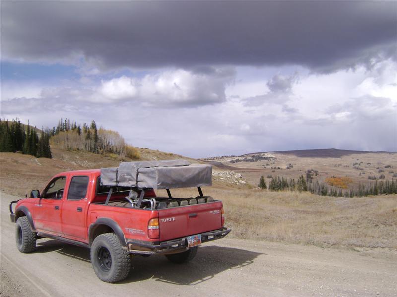

Mine started here, but ended up on the roof as when I lifted the rear bed cover it caught on the rear roll bar.
It fitted straight onto my Mountain Top cover as the cover has a rail around the edge.

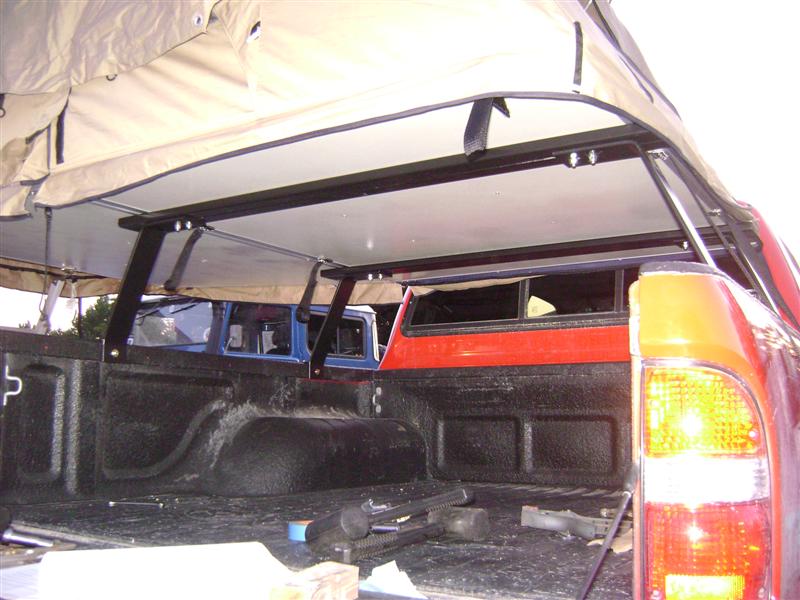

That's a very nice RTT holder. Do you have any pics on how it attaches to the bed? Did you design it yourself? If so... Why did you curve the support beams? Does it add strength or is it just for a little flash? :) How much room is there between the cab and the rack? You have flexed the truck... does it come close to touching with the frame twist of the box? Sorry for all of the questions.... I'm looking for a Winter project.

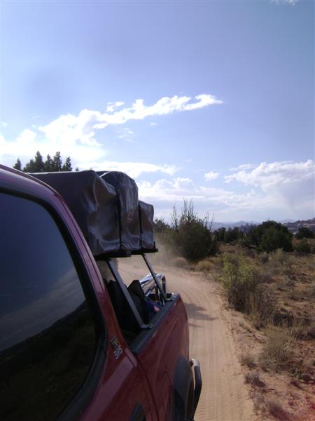

I'm running the new Bakkie system from Equipt, first one in the states I beleive though he has more in stock ;)
Have had it on a couple of trips thus far, with another planned this weekend. I installed it late last month in prep for the annual "Outlaws Run", we spent 5 days bombing through Southern Utah including a time shattering 4.5 hour night run from Hanksville to the Dollhouse via Poison Spring (takes 6-8 usually). The Bakkie didn't skip a beat, though I must admit I was slightly worried about the aluminum over such rough terrain. So far so good :cool:

I remember going through some of the same questions. I had a very simple design that I took to a local fabricator. He added the flash since he "didn't want it to look like a painter's rack". The styling matches elements of the truck and I really like it. I just measured the space between the cab & rack: 1" in the center, 2" by the doors due to the roof slope. I'm not much of a rock crawler, but I've flexed it out several times with no problem. I should make a point to get out and notice how close it gets. I posed this same question to DesertDude who has the same kind of rack. He hasn't had any issues with 1" spacing either. The fabricator I used was a little concerned with stability from side to side and I thought there might be vibration on the front piece when I use the lights... but it is proven to be real solid. It is attached by bolting onto the adjustable tie-down tracks that come from Toyota. I'll find a picture and attach it here in a minute.
