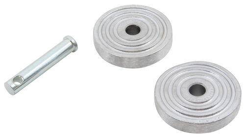

Some anti-theft methods I use.

Trailer pins do not prevent theft. A 4.5" battery powered angle grinder with a cut off disc will have that pin laying on the ground in less than 30 seconds.
Something like this for a trailer hitch, made specifically to work with your trailer and vehicle will almost guarantee you that not only will your trailer not get stolen, but that your friends cannot borrow it and return it damaged.
HEAVY graded chain through the all wheels with a beefy, high security lock, will deter thieves, but again, this can be easily cut in just a few seconds with the right tools.
Do a search for something like "best trailer locks" and see the $30 Chinese junk that comes up. People spend tens of thousands of dollars on motorcycles, ATVs, side by sides and tools, then try to protect their stuff with a cast $30 Chinese made Master Lock.
Pathetic.
Depending on the location, motion activated game cameras, video surveillance signs and some Glock or Remington stickers are your friend. Chock and block the trailer, let the air out of the tires and use high security padlocks on doors. If the lock came from Home Depot or Walmart, you can assume it is complete crap. High security locks do not cost $30 and are not sold at big box stores. Spend a few hundred dollars on a lock made by someone like Assa Abloy and protect your stuff.
DzlToy
I can forgive you for not clicking on the link or reading thoroughly or possibly for having concerns about a heim failing in that application, a trailer coupling. For clarification, this is the heim in the link above. Just try and break it.
EDIT: It is far superior to the $50 bolt on trailer tongue that many people purchase for DIY builds and many/most professionally built trailers that I have seen. Radial load rating exceeds 140,000 pounds and 56,000 pounds axially. Towing an 80,000 pound trailer, this is an issue; towing a 416 or a tear drop off road, no worries.
