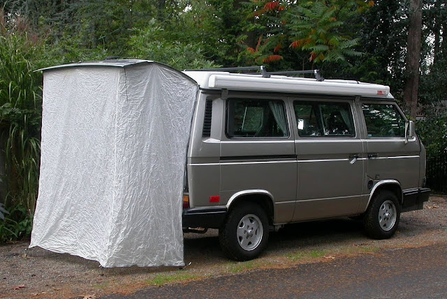

More food for thought on the rear-of-van pop-out: Here's a few pictures of a solution from Safari Condo for the Astro/Safari platform:
This is an interesting solution given the short nature of the Astro/Safari and the limited interior space. You can see in the photos that roughly half the bed is outside the cabin. In this case, the upper dutch door is still in place and supports the rear tent. I don't have any photos from the outside, but I imagine it looks similar to this rear-hatch tent for the VW's:
I will probably consider something like this for my van as a "version 2", to gain some interior space at least in "tent" weather. When using a more traditional layback sleeper bed, I'm struggling a bit with storage underneath, since it sits pretty low to accommodate headroom for the "seated" position. This implementation sits up higher (over the back of the fold-forward OEM seat), which reduces sleeping headroom but should gain significant rear storage height - enough, perhaps, to relocate my fridge to the rear where it currently must be up-front.
