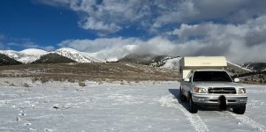

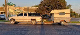

I bought this Teton Traveler almost a year ago as a finished, empty box. Previous owners mostly kept it in this trailer and used it like a camper trailer, and it was really just a sleeping area, not really a "camper". I definitely like having the option to pull it behind me sometimes, and not have to put it in the back of my truck to use it. I plan to mostly use it as a hunting setup in my truck bed (hauling my pull-behind trailer down rough, snowy roads in the fall was killing it and it's never fun to pull a trailer in the snow...), but also a few times during the summer, most likely.
I'm starting to build it out, just doing very simple stuff to make it more comfortable. Trying to keep things within my current skillset, and keeping weight down to a minimum. Most of what you'll see for my choices has to do with: what I actually have the skills to do, what I can afford, what's most lightweight given those first two limitations.
What I'd really like advice on is getting propane set up safely. If anyone can point me toward a thread covering that, I'd appreciate it. It's currently got a hole cut in the wall with a soft propane line feeding a Wave catalytic heater. From what I've seen in other campers, it seems like soft lines are ok outside the camper, but there must be some regulation that says interior lines need to be hard.
I want to keep this as simple as possible. I want one soft line coming from the propane tank to the exterior wall, connecting to an interior hard line with one Y right on the inside wall of the camper. I'll have a two burner stovetop and the catalytic heater, no other gas appliances. I can buy a propane line bending tool (the really cheap kind) to take care of some very minor bends, but hopefully build things so that they connect fairly straight, without bending.
Let me know if you've got ideas, and thanks!
