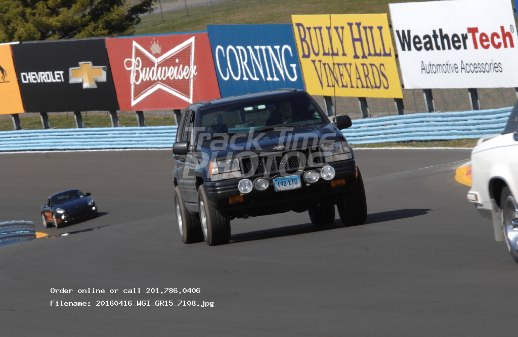

Over the weekend, I took the ZJ down to opening weekend at Watkins Glen and used it for some non-expo things:
5.9 ZJ ******! :wings:
I also dropped some new cylinder heads on it the day before I took it down there. Valve guides in my old heads were getting pretty worn and these flow better than the previous heads (which were already better than stock). It's definitely got some kick to it. I've never had the thing notably put me in the seat all the way through 2nd (up to 90) until now :smiley_drive: And it's only going to get better once I get the new throttle body on it (current one is way too small and costing a decent bit of power) :victory:
