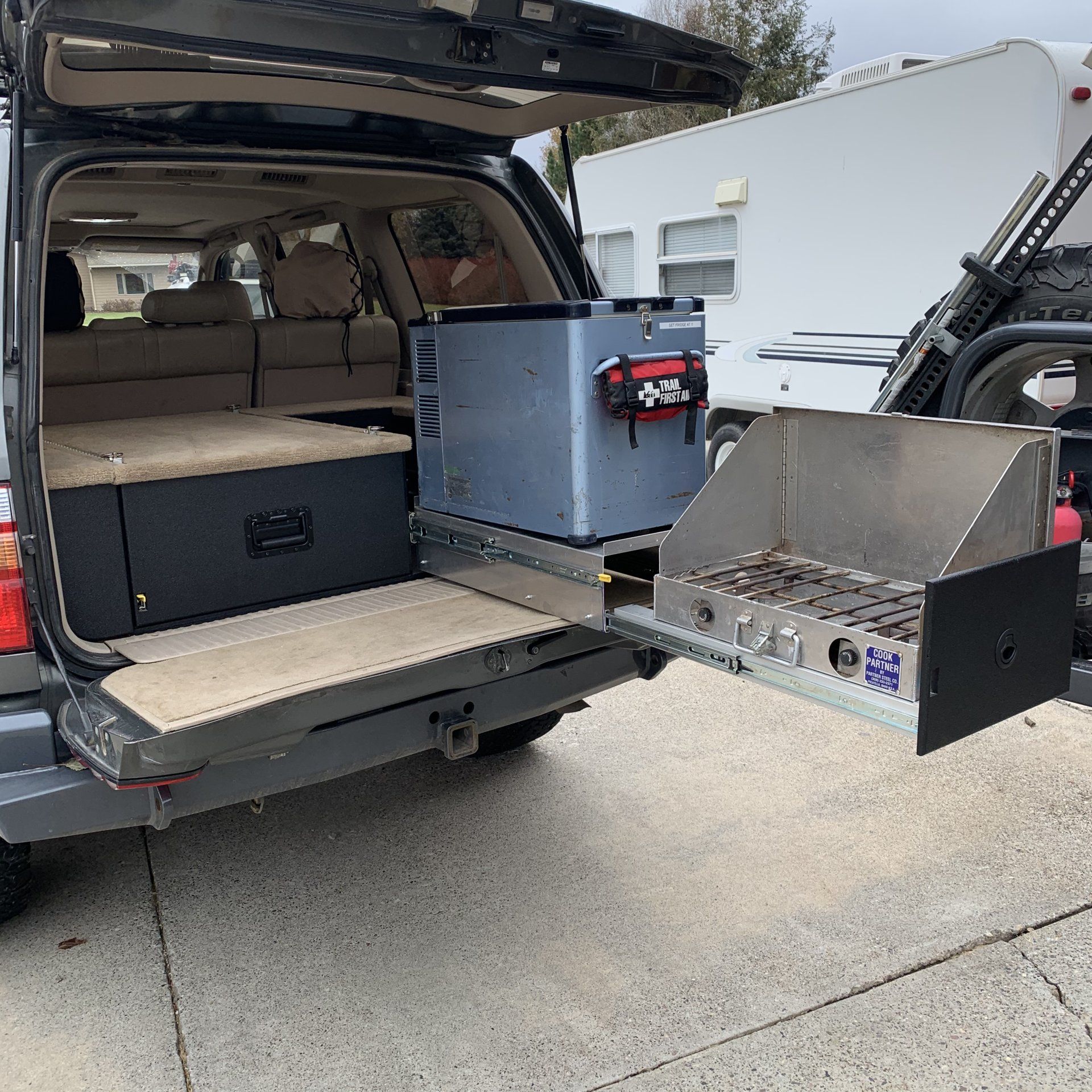

Finished these up this week...
Drawers house:
  • Main storage drawer for recover/tools/spares
  • Engel Fridge on slide
  • Partner Steel stove on slide
  • 16 gallon water tank
  • Shurflo water pump
  • Shurflo faucet
  • Comtek 150w inverter with 120/usb outlets
  • Alpine 500w sub amp
  • Blue Sea power pole
  • Blue Sea fuse panel
  • Switches for interior/camp lights
  • 12v battery monitor
  • Air compressor storage
6d11be9e-0ff2-467d-8b92-3330f2f9935f-jpeg.2110516
Fridge Slide
ff12ef16-57c6-459d-898e-6d2923fde82b-jpeg.2110525
Stove Slide out.
f58e3c49-9624-4e3b-9744-4bdbda9d6efe-jpeg.2110527
Plywood floor, ARB fridge/slide and ARB drawer. OEM subwoofer relocated under fridge. Does not play well with Teraflex cargo thing, can no longer open fridge completely.
Drawers house:
  • Shurflo faucet
Fridge Slide
Stove Slide out.
