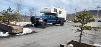

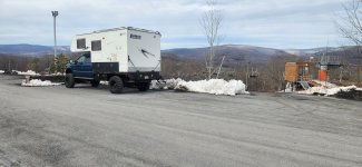

I just don't the have energy to work on stuff and post about it too but I finally got to use my camper this year. Currently doing a manual trans swap and need to redo a couple things including rear tie downs. Hoping to use it all ski season. I hate when build posts just stop mid build. Btw tire up front did not work for me when spring came. The higher temps outside didn't allow the truck to cool itself efficiently.20240408_161844.jpg20240408_162604.jpg
