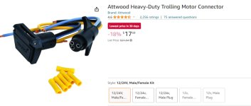

I'm not sure if you wanted a 12vdc or 110vac connection from your post. If 110vac I use a NOCO that others have mentioned. If you are looking for 12vdc, trolling motor connectors are a good choice for up to 70 amp
