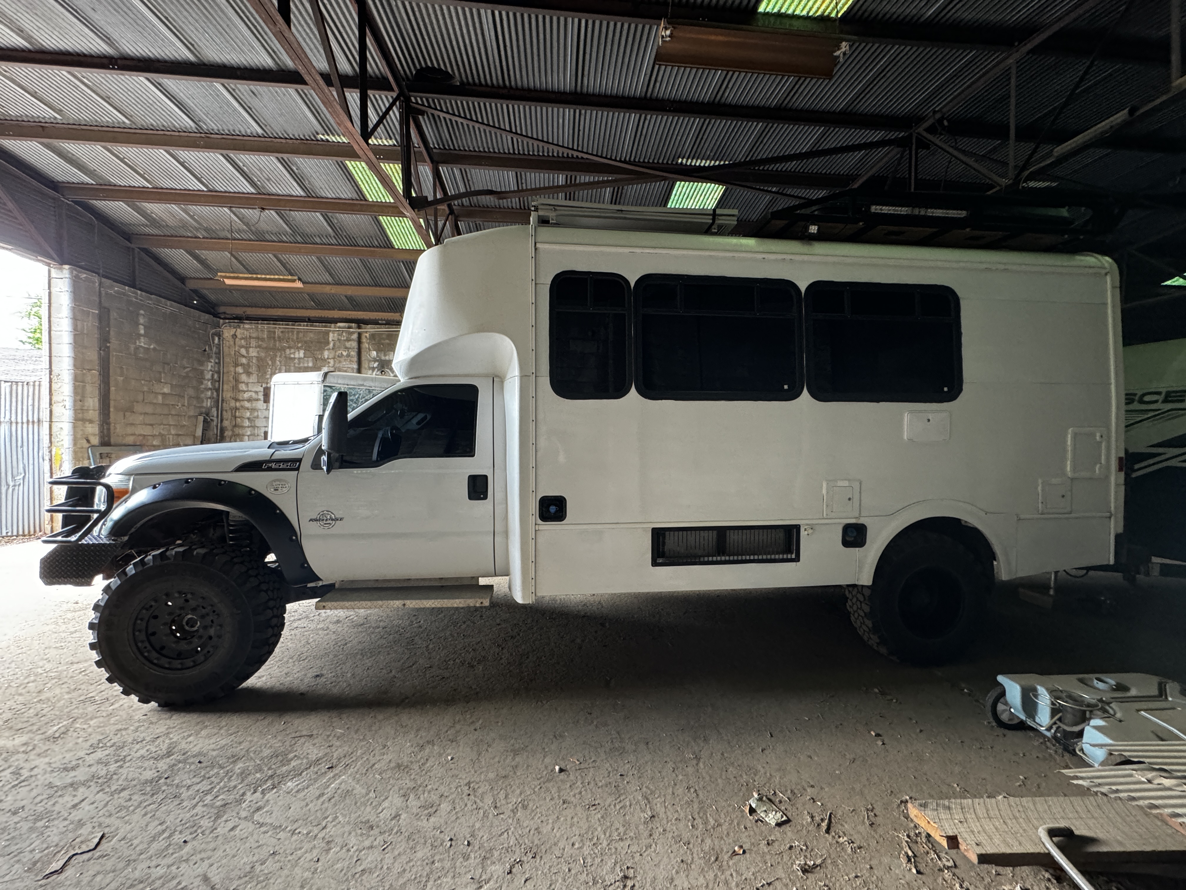

Price drop: 2011 F550 4x4 Beastly Baja Bus. New 6.7 Powerstroke. Get off grid and stay off grid. $104k
Robbus
Overlanding 4x4 Bus. Ford F550
chassis. Located in Greenville, SC
Ready for adventure.
Features:
6.7 L power stroke. New motor w Ford warranty installed 6000mi ago
121,000 mi on chassis
75 Gal Freshwater
25 Gal Grey water
25 + 30 Gal fuel tanks
Whale diesel heater/cooktop. Very efficient
5 Gal heater diesel tank
Warn 17.5K lb winch
2048 Wh BLUETTI 200AC Max Li power pack
600w roof solar
100” x 90” roof deck
Lockable Underbody storage boxes 18”x36”x24, 18”x80”x24
Ranch Hand Brush guard
Low chassis miles 121k
LED scene and backup lights
27” 4K smart TV (WiFi, Netflix, Hulu etc)
Cassette toilet and shower combo
4.8cu ft Fridge
Microwave
Sleeps 5-6
DBL Designs 2.5” lift
320/80/20 Continental MPT 81 (41” tires)
Bilstein shocks
Massive interior storage
Dual receiver hitches for simultaneous towing and bike/moto carrier
Starlink antenna holder
Quick access Jerry can, shovel, traction board storage

Interior photos. Happy to share a video tour of the rig if interested.

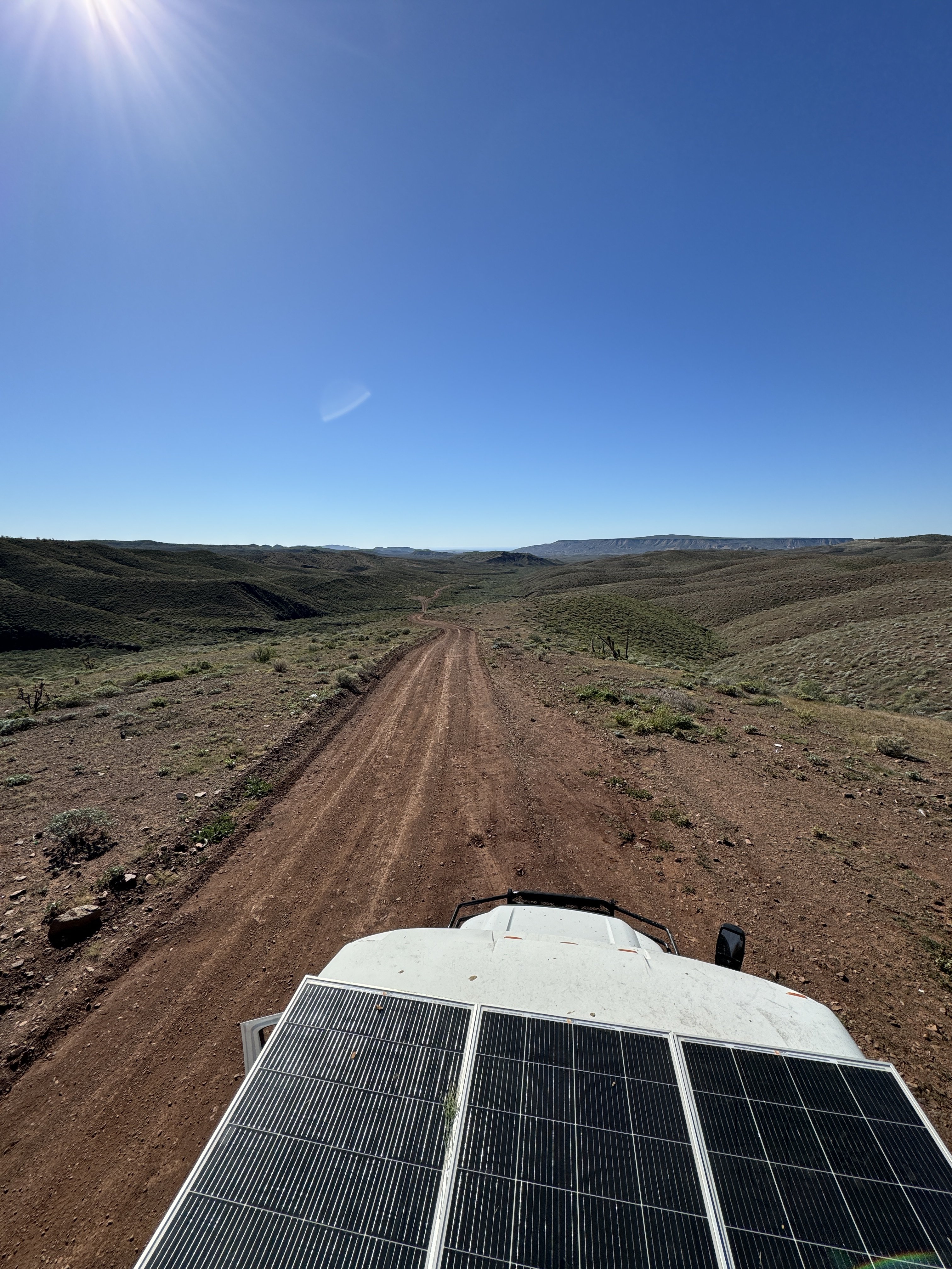

It does very well though I’m not looking for opportunities to maximize articulation. Here’s a pic of a pretty articulated section of trail. No problems.
