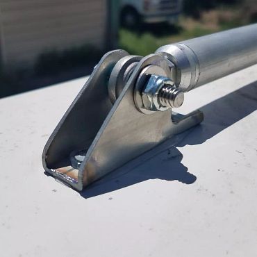

A little repair and rebuild on the Flippac. After a few trips to Moab, Utah with some hellacious wind storms, the struts needed a rework. I broke one of the factory plastic bracket on the roof and lost one of my new aluminum struts.

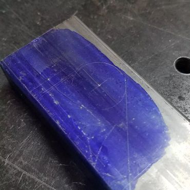

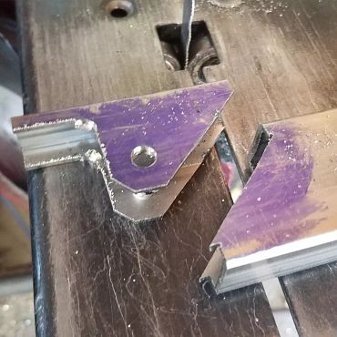

I remade the strut brackets on the roof panel out of some stainless steel box tubing. They should be WAY stronger.

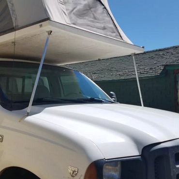

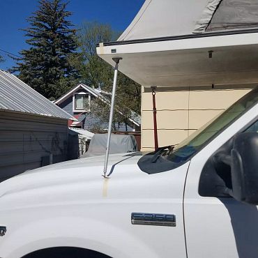

I then moved the strut brackets on the hood so that the struts where vertical in side view. This makes it much easier to pull the bed down and get the tent tight. It also makes folding the rods up a little easier. This should work WAY better overall.

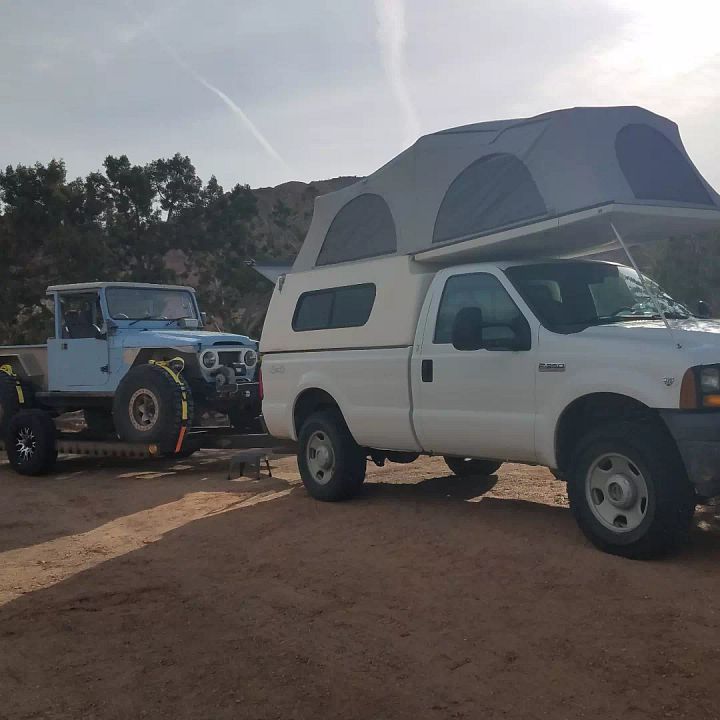

Putting the truck to work hauling the #LX45 out to California and back for a Rubicon trip. This is pretty much exactly what I built the truck for, basically a daily driver that I don't have to do major re-configurations on to support trips like this. The Flippac lives on the truck full time and is basically just a big fiberglass camper shell when closed. This lets the truck do truck stuff without having to remove ( or store ) anything. Even this basic truck has the important things I need for a longer trip...mainly just Cruise Control ( I have a dodgy knee that hates staying in one position ) and A/C to keep the temps down on the road with the windows up at 80mph. Beyond that, it is just a super basic truck, and I like that.
The new trailer I built is working great too. It is very compact, low behind the truck, and pretty lightweight. The truck still returns (low) double digits towing around 5k+ with the V10, 6spd manual, and 4.10 gears running the speed limit +5 on regular unleaded. I can't complain about that for the investment in the truck at all.
Camping in the Flippac on trips like this is so conveinent. Setup ( and takedown ) literally takes less than a minute. The new strut rod setup is working much better. I am not always worried about breaking the old plastic hardware anymore. I usually just throw sleeping bags in a big plastic tote with a few pillows. That keeps the dust down, since they are in something with a lid, but the box is big enough you don't have to kill a bunch of time trying to pack things back in a tight stuff sack. Having the extra storage volume in a vehicle this size is nice when comparing to my history of packing very small and light for big trips in my other off-road vehicles.
