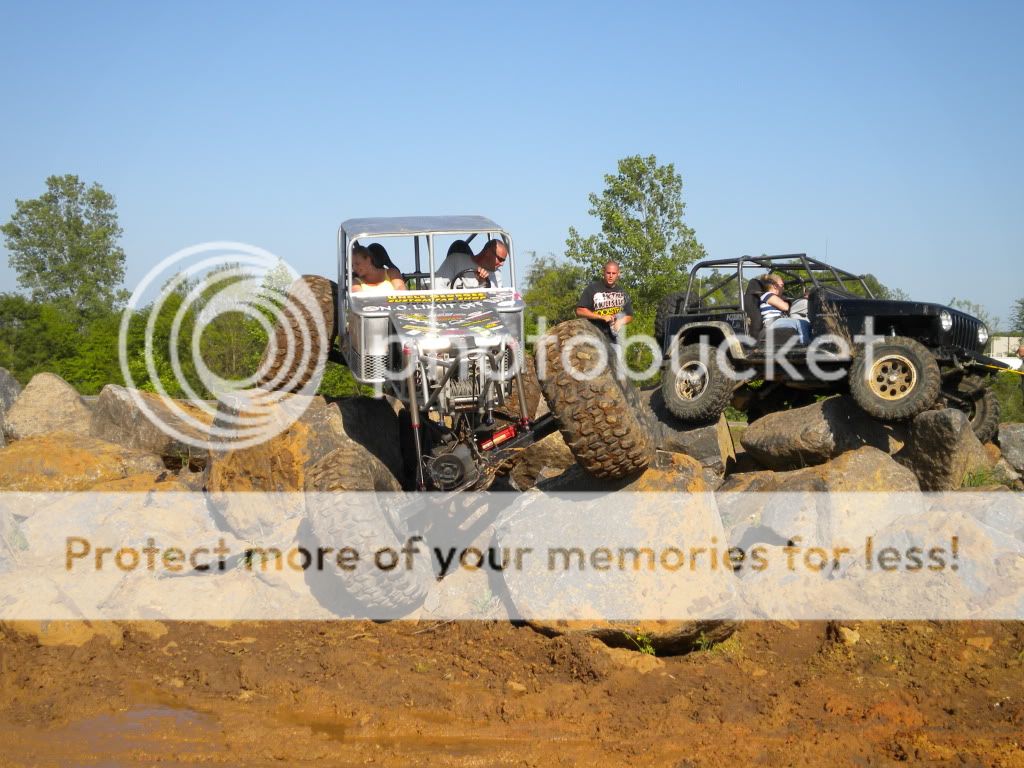

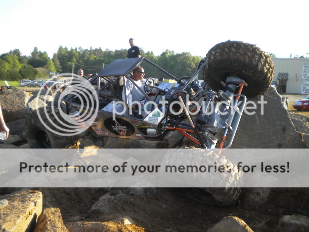

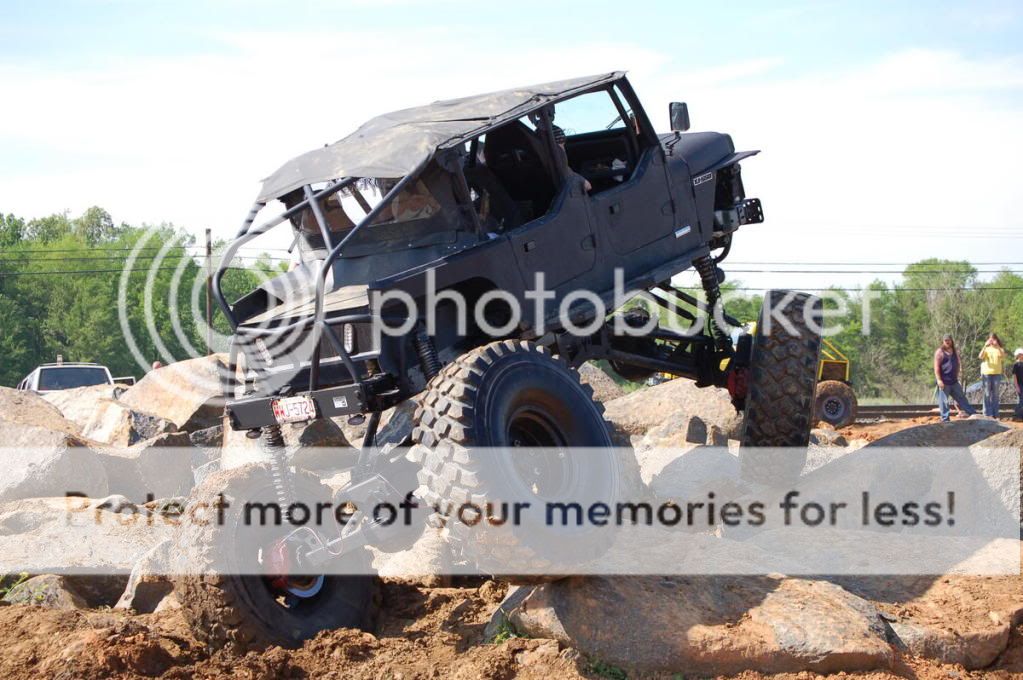

The front will be leaf springs, from here http://www.bjsoffroad.com/cartgenie/prodList.asp?scat=126. Whichever height Chris(builder) thinks it needs. as far as everything else goes, its whatever he thinks will work best. He makes most everything in house (full custom 4x4 fab shop)
His last couple builds....
Ground up build
Ground up build on the silver jeep buggy
everything from the frame down done by Chris
So, im getting him my axles, wheels/tires, transfer case, Bilstein 5125's and my winch.
Anything else he needs, he either has in stock, makes or can order for cheap.
