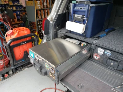

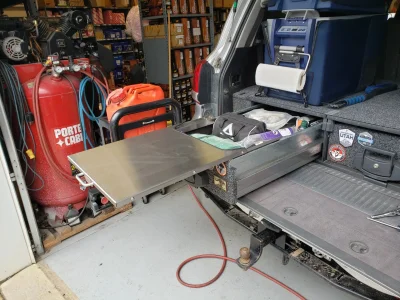

April, 2019: We just took delivery of the new stainless steel drawer tables and bags for the ARB Outback drawers. Totally digging these!

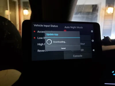

November 2019: Lots of updates but I haven't taken the time to document in the last year or so. The ARB Linx is fully setup with the pressure control, rear locker, dual control, fridge control, etc. I've been absolutely loving that. Installed the 12 gallon LR aux tank, new OME rear springs to accommodate the added weight and a front suspension refresh. My BP51's were the oldest in the US and still working great but it was time to do PM in prep of an upcoming Mexico trip. I did new upper ball joints at the same time. A few pics until I have time to document.
Updating the ARB Linx with the latest modules

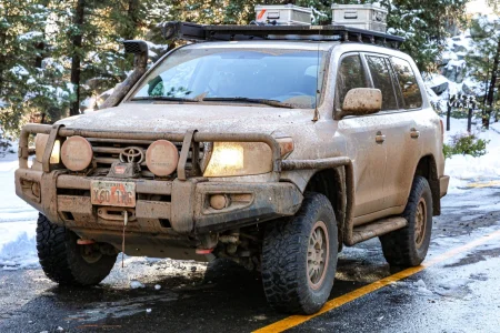

June 2021 Update: No real exciting updates, just working this 200. This machine has been on some serious trail/race pit support duty the last few years, annual trips to the Baja 1000 and other dersert races supporting Canguro Racing & Jaos in their LX600, King of the Hammers supporting Rusty Nail Racing, Mint 400 supporting @landcrusher909 and a bunch of Lexus/Toyota projects. All this and some fun personal trips too.
