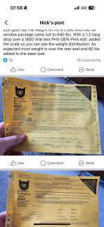

As for weight, CAT Scales have to accurate. There are now two people. The full size truck camper guy with 800lb camper you mentioned and the 660lb tacoma guy I mentioned. Cat scales can have something like 20lbs of variance over 10000lbs. The full size guy you mentioned I think even weighed in at 2 different scales. These are extremely heavy campers in this segment. I will trust the cat scale over what Tune is saying their campers weigh. Ask yourself what are these people to gain on the forum lying about camper weights?

He did weigh it twice in total, and he came back later and said actually the weight of his camper is in the 600. It’s a long bed full size with options.
You forgot to mention the guy below, full size truck long bed, with options including full heavy tempered glass window package, cat scale weighted at 640. How can this one be 640 with the full window package on a HD truck, and the other one 800….
Yes those people have nothing to win but they weight at different days on different scales and forget they added things in the back in between.
Anyway. The M1 weight on a regular full size without options is in the 500, and in the 400 on the regular short beds.
