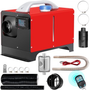

Diesel is definitely intriguing to me. Right now the camper has no power (one of the reasons the catalytic heater is so nice), so it's a whole other project to install something that requires 12v. It's these dang slippery slope installs and all the incidental, unexpected costs.
Like..."oh, only a $114 for a diesel heater, I can afford that no problem!"...then a battery, battery tray, wiring, control center, fuses etc. etc. and suddenly I'm in $500 and several weekends 😄
But that's the way it goes. I've been looking at this camper as something cheap to get me through till I can afford what I actually want, which is a pop-up slide in camper. If I'm not careful, I'll end up putting so much money into this camper that I should have just saved up for what I really wanted. This camper cost me $550, including the truck-bed trailer. That's why I bought it. Trying hard to mostly use it as-is, rather than make everything exactly how I want it.
