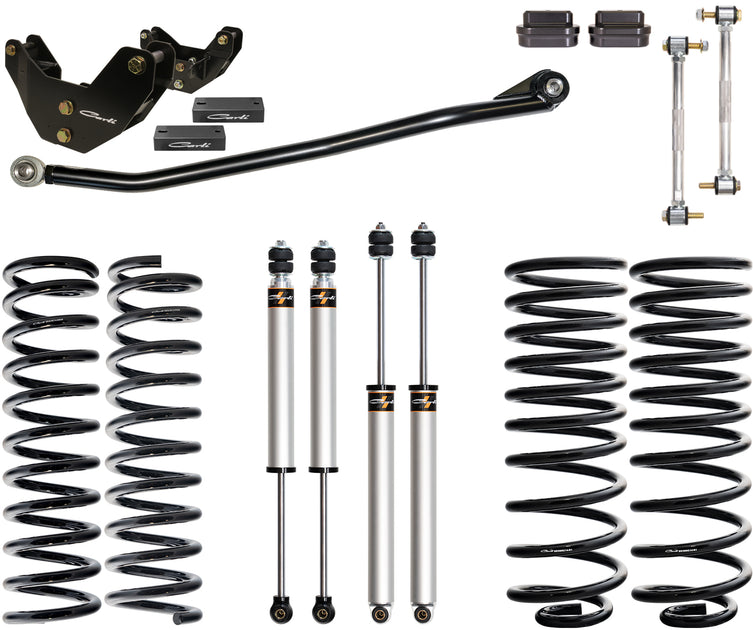

Why not a Ram Power Wagon with a Carli Suspension System?
- From the factory you get Front/Rear Lockers, 12,000lb Warn Winch, and a Disconnecting Front Sway Bar
- Put a Carli Commuter Suspension Lift on the truck and run 37” tires
You also get 1,500lb payload…
