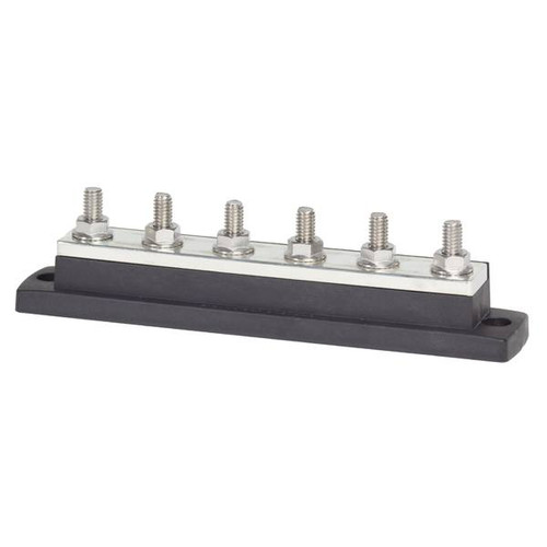

I reconnected all six positive cable to first positive battery terminal post, and order longer 2 AWG black cable to run to far battery negative post per CMARJeeps link according to Method 2.
My positive terminal looks pretty crowded with six connectors not sure if great setup.. Would the Blue Sea 250 AMP 6 stud bus bar linked below be correct for my needs? Also, since I have 6 cables that will connect to bus bars 6-studs, I will not have a free stud to connect to battery, do I double up leads on one stud to leave a free stud to connect to battery?
Big thanks in advance.
broncobowsher
Never run all the batteries to a common point. Unless you can get the cables the same length all the time. Voltage drop from different cable lengths will load/charge the batteries at different levels. There is a way around this. For a 3 battery setup (same applies if you have more or less) take the single load/charge positive cable to battery 1, jumper from 1 to battery 2, and another jumper from 2 to 3.
Ground is the opposite. Jumper from 1 to 2, 2 to 3, 3 to the load/charge. What this does is evenly distribute the voltage drop through all the batteries. Battery 1 has a direct feed off the positive, but two jumpers to ground. Battery 3 has two jumper to positive, but a direct feed to ground. Battery 2 has a single jumper on each, so a total of two. This will do a much better job of keeping the batteries balanced.
This also eliminates the stack of cables on a single point (and you super long bolt needs). You can disconnect the battery bank with a single cable.
