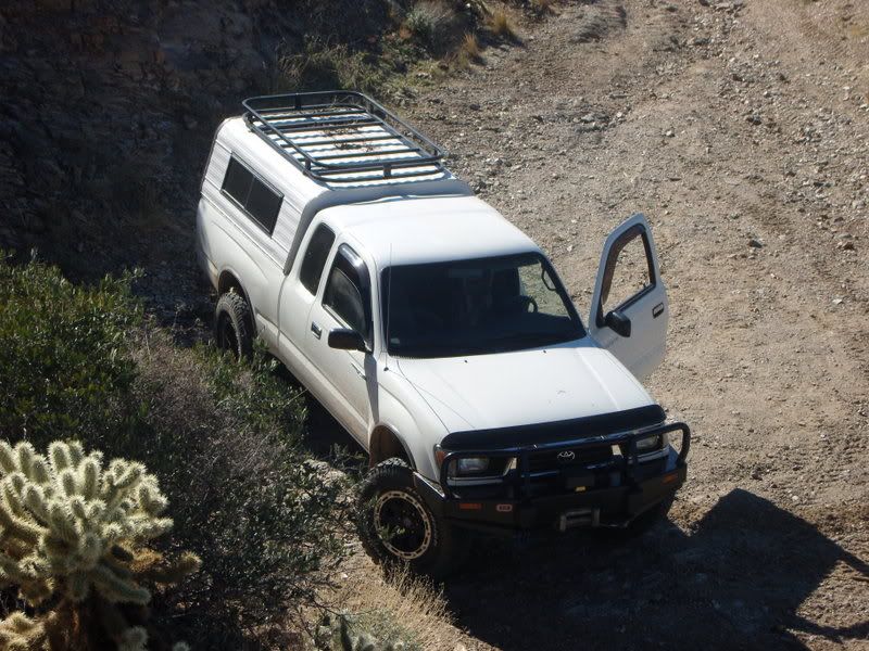

Here is what my origanal set up looked like. the RTT was as close to the topper as possible made travel easier and getting to the zipper for the cover, as well as deploying it easier.
Super cool rack. Thats a lot like what I am planning on doing with mine this summer. I have a rack already but it wont work with my softtopper. So I am working on an internal rack that support the RTT above the softtopper.
