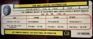

Hello all. I am new to the forum, however, I have been stalking as a non-member for a long time. I love seeing everyone's builds! My wife and I want to get out more and go camping/exploring. I figured a more dedicated vehicle for this would make things a little easier. I want to build a rig that is self contained (no trailer). Living and exploring in the mountain state, we find ourselves down a lot of very narrow mountain roads and forest roads where turning a truck around is sketchy at best. I can't even imagine dealing with a trailer in these places. Our current camping vehicle is a 2018 Ram 1500 Sport regular cab 4wd. It has no real modifications done to it. I had line-x put in the bed, got some weathertech floor mats, and tinted the windows. I love this little truck. Of all the trucks I have owned, this one is probably my favorite. I want to retain the ability to use my truck as a truck if need be, so we are leaning in this direction: decked drawers, softopper, xtrusion overland rack, wedge style rtt. Those are the basics, however, bumpers would be nice, the stock front bumper comes way down (actually decided against a creek crossing yesterday because of this). I don't think I really need a winch, so something like a pre-runner style would likely work (just want to get better approach angles). There would obviosly be suspension upgrades as well, but since they dont increase payload capacity, I won't go into that at this point. This vehicle is technically my daily driver, but my wife and I work at the same place, so we can take her Jeep Grand Cherokee most times. After finding our direction for this build, we were quite excited and ready to make things happen. I had been watching Youtube videos on overland stuff, just trying to learn every little thing I could before we embarked on this journey of putting together a rig, when I stumbled across a video on gvwr and running over on weight (I believe it was on the outdoor auto channel). This of course prompted me to go check my B pillar sticker and I was somewhat surprised by what I found. My payload capacity is only 1248 lbs. This is probably not panic inducing for most folks, but my wife and I are not small people. I am 5' 11" and 350 lbs (I am working on this, lost 3.5 pounds just this week actually!) and my wife is around 230 lbs (dear lord don't tell her I posted that on the internet). So after taking nearly 600 lbs for just occupants, that leaves me with 648 lbs for all the added stuff. I do tend to be minimalistic in my approach to camping, but even then, I feel like we are going to go over weight regardless of what we do. I could fit most of our stuff in the decked drawers. Large items would include a cooler, aluminum camp table, 2 chairs, shower tent (for anything longer than a weekend), a chuck box, and 1 or 2 NATO style 5 gallon water cans. We also want to use this rig to do some 1 to 2 week road trips out west once or twice a year. I don't plan on doing any serious offroad. The truck will be used mostly on mountain roads, gravel roads, and highway. I have no problem with easy trails and shallow creek crossings, but I'm not going to be doing anything that would potentially end in complete destruction of my truck. So the question is, should I even bother starting down this path? Can I make this work or should I hold off and look for a 2500? I am also curious to know if a wedge style rtt can support our weight (or any rtt for that matter). We like the wedge style for quick tear down of camp, especially in a road trip type scenario where you pull in, make grub, catch some shuteye, and hit the road at first light. I do realize that a rtt is not absolutely necessary, but if possible I would like to get up off the ground. I have attached a photo of my B pillar sticker, not sure there is any other useful information there though. Thanks in advance for any guidance y'all can provide!

If you want to use it as a truck, an easily removable pop-up camper and air bags would make sense. I'd recommend better shocks also with a mild front lift, and heavier duty tires a little larger than stock. As for the bumper, a sawzall should work well on the parts that hang down too far...
Yes, you will be "overweight" like pretty much everybody else... GVWR is the manufacturer's liability and warranty #. It isn't illegal to be over it.

I was leaning toward a Bilstein 6112/5160 setup and just level out the front. I was thinking about getting the factory 20's off of there and going to a 17 or 18 inch wheel with a tire in the 34 to 34.5 inch range. I am absolutely open to suggestions though.
I have not looked much into campers other than the GFC one with the integrated rtt (not sure this really qualifies as a camper). What kind of camper would you suggest? I don't know a lot about air suspensions, other than my old rebel had air ride and it was cranky as all get out when the temperature got down below freezing. That was pretty much my reason for trading it in on the truck I have now. That, and I couldn't stand that tiny bed. You put a cooler and two camp chairs in there and it was nearly full (I'm exaggerating a bit, but you catch my drift).
If everyone is running overloaded ... I guess my next question is, how much is too much? I obviously don't want to make my truck unsafe or make it handle in an unpredictable manner. I also assume that taking it to the dealer for service with 2 tons of extra stuff on it could cause me some headache in the warranty department as well?
Well, it depends . . . on a lot of things. Known weak points of the truck, where and how you drive it, how much you drive it overloaded vs not, where the overload is (eg, is it your HD springs, suspension, airbags, tires, wheels or other things to make it better able to handle off-road conditions and loads, or all sorts of heavy things up higher that create other issues and weight weaker parts of the rig) and finally, how in control of your rig you can be with the weight.
What I’ve settled on personally is I’m not gonna let it get over my combined axle ratings, which are about 500 [edit:] 900 lbs higher than my GVWR. Also, a not insignificant part of my weight unsuspended and things done to handle the weight and rig better.
You’ll find thousands of threads and posts about this and everyone has their opinions. Nothing you do is without some risk, but usually, you can manage it within reason.
Your suspension and tire thoughts sound fine. I'd suggest keeping your front lift to 1.5-2". Any more and you'll need to lift the rear, probably need UCAs, and front end parts will wear out sooner.
I'm not well versed in campers, but the light pop-ups like Four Wheel Camper are pretty well liked. I was thinking that a camper you can completely remove easily would make the most sense, since you want to use it for truck stuff. Scout is a non-popup that is pretty simple. It seems that old campers were often lighter than the newer ones, if you can find one in good shape.
If you take it to the dealer, the camper will be at home, so...
Air bags (and cradles are a good idea also), are just adjustable boosters for the rear suspension. Firestones are common... I bought Torque brand which were half as much, and no problems yet.
If you make appropriate tire and suspension upgrades, and drive like an intelligent person who knows he's carrying a load, the axle ratings are usually a good limit. However, these aren't necessarily based on axle strength, rather shocks and springs and tires might be the limiter. Even better, check other people's experiences with hauling a camper with truck models similar to yours, and see if durability issues have been noted.
