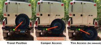

More YMMV. I got my Road Armor Bumper for free thanks to Jeff Bezos (actual $550 ahead, with selling the Ranch Hand bumper that was on the truck), and building my own swing (to the side, not out) mount so I can access my camper, $50 additional in materials. So I guess -$500 in direct cost?
The wheel/tire has to angle out at 20° when the camper is on to be supported by the bumper and still clear the camper. When the camper is off, it can be adjusted to a vertical (0°) position.
