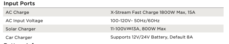

The issue is that your EcoFlow limits how much power it will accept so it doesn’t matter how much power you’re able to generate via the alternator:
The battery management system (BMS) of the EcoFlow is going to limit the input power regardless of what you throw at it or you’ll melt parts (as you have already experienced). Because they don’t intend for this unit to be used the way you’re hoping, they’ve set up the BMS to favor AC charging (at a wimpy 15A!). Save the money on a Orion XS until you’re ready to upgrade to a different energy storage system.

You missed the point of the powerstation specs posted above... there is a 13A or 800W limit. There is also a limit on what your alternator puts out without burning it up, and its probably less than 500W.
Also, good reliable devices to boost alternator 12v up to 48v with at least 350W output are very few, just 3 found so far. The ecoflow, the Pecron, and the Victron.

I think you are not understanding how this works.
The DC car charger input you are currently using is limited to 8A - doesn’t matter how much power you supply, the EcoFlow will limit input to 8A.
When it comes to electricity, it is easier to compare wattage rather than amperage. Watts = amps x voltage. Just increasing amperage alone won’t make anything work out better - in fact, it will probably damage the existing wiring. Likewise, just increasing the voltage won’t help, either, without some method of converting that voltage back to whatever the EcoFlow wants.
This means at 12 volts, the max the EcoFlow will accept (not what you supply) at the car charging port is 96 watts. If you did what the video suggests, without knowing exactly how the EcoFlow BMS behaves, the maximum amount of continuous power the EcoFlow will accept is 896W (800w max solar input + 96W max car input). That is a pretty good bump and maybe all you need.
If you want to charge it was quickly as possible, your best bet is cobbling together some sort of AC power source from the alternator (alternator -> batteries -> inverter -> EcoFlow). Even including conversion losses, that would probably still be a decent amount of input wattage when compared to either DC alone or DC + solar.
