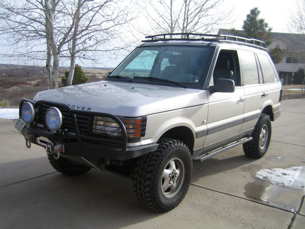

A couple of items to think about in this regard: if you do stick with the EAS, you can use Gen3 air springs (such as these http://www.suncoreindustries.com/la...r-spring-bags-with-shocks-replacement-kit.php this is w/shocks and springs - they also have a coil conversion), longer shocks, free EAS Unlock Software ( http://www.rswsolutions.com/index.php?option=com_content&view=article&id=53&Itemid=56 ), and slightly modified rear height sensors to do a moderate lift. A replacement compressor seal can be had for about $15-25. When all is said and done, your parts cost is roughly the same as a coil conversion but your labor will be less.
And you retain the benefits of EAS (which is generally not unreliable if serviced every 4-5 years - though the RRC/P38 are a bit more 'special' than later LRs). One benefit came to mind again as I was reading through the OJ LR4 thread (pics below): you can have your RR lifted for off road use while retaining the handling characteristics of a stock vehicle for the street. The handling of permanently lifted vehicles invariably suffers due to the lift.
A few good shots of the ground clearance in "off road" suspension setting
I am an avid follower of the KISS principle, but there are trade-offs - and they are often not adequately considered. If you are planning on going to 35"+ tires, disregard the above...
