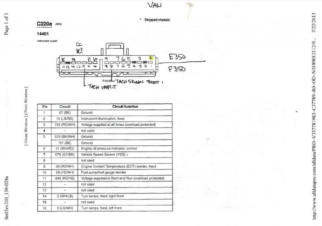

ive done the gauge cluster swap as well. i have pinout diagrams from my 03 7.3 van and the (iirc, an 01) f250 pu the cluster came from, but photobucket has my digital versions on lock down. i went back and looked at them and my notes make no sense to me now, and none of the van diagrams show the rpm signal. so im not sure where i found that info, but my tach does work. only thing that doesnt work is the cc light. there was 2 choices and my first choice was wrong and just havent had a chance to fix it yet. im also hoping that the 2nd wire that comes up from my transfer case is the low gear light that i can hook up as well.
im currently looking for my hard copies of those diagrams in hopes that there is some method to how the hell i did this swap and maybe some info regarding the actual rpm lead. ill post them up if i can track them down or maybe screen shot from photobucket if you think it would help. ill post links to them either way maybe you can view them there??
excursion/f250 cluster plugs:
http://i231.photobucket.com/albums/ee182/shenrie/van build/f250B_zps5dc6d6d0.jpg
http://i231.photobucket.com/albums/ee182/shenrie/van build/f250A_zps9222c420.jpg
http://i231.photobucket.com/albums/ee182/shenrie/van build/f250C_zpsd9bd8e6d.jpg
03 7.3 cargo e350 cluster plugs:
http://i231.photobucket.com/albums/ee182/shenrie/van build/e350B_zpsf83bab05.jpg
http://i231.photobucket.com/albums/ee182/shenrie/van build/e350C_zps4aec2669.jpg
http://i231.photobucket.com/albums/ee182/shenrie/van build/e350A_zpsc9a914b6.jpg
