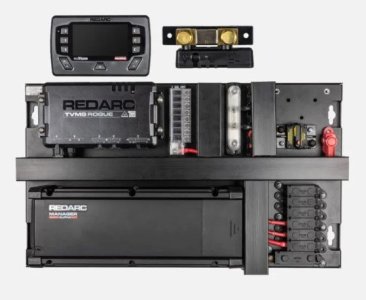

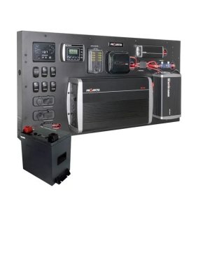

Some companies make these finished cabinets/enclosures for mounting and routing electrical equipment in vehicles. I am trying to source just this enclosure, or a similar one. I have emailed about four companies in Australia, including Redarc, but none have replied. I am hoping there is something stateside to save on shipping but if that is the only path then so be it. I already have the Redarc Manager 30 Redvision combo Rogue/Prime package so I only need the enclosure. Seems these companies want to sell their completed kits for thousands of dollars over the parts alone just to wire them up. Well, I wire up nuclear plants so I think I can handle it.
Ideally the size I would need is 16"x30" with max 2" of depth/volume in the enclosure. The length and width can be fudged a bit but using a 4' deep box is not in my ideal situation. There has to be something out there, digikey doesn't have it. Most enclosures I find are for industrial applications and not something you'd really want in a vehicle simply because of sizing. My space will be in my Land Cruiser on the side of my Trekboxx fridge cage, so space is limited.
I get that they want to sell completed packages, but that isn't something I have any interest in.
I have added a couple of examples for your viewing pleasure.
I imagine the enclosures are something they make or have made for them custom.
The closest I can think of are thin IEC enclosures (like Eaton B-line below) but those are going to have a door and full back, which may be redundant in this application. You know what I mean, for control panels, meter boxes, service entrances and such.
