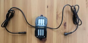

Each LED unit has two connections; as I said they're intended to be daisy-chained together, one after the other.

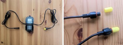

I have one small suggestion for Auxbeam: Since the LED units have two connections so they can be daisy-chained together, the last unit in the chain will not have one of its leads connected. I thnk it would be a good idea to cap off the unused connector to protect it from dirt, etc. so I used thread protectors, intended to cover expsed screw threads. They come in a size that fits perfectly and can be found at most hardware stores, here's they are at Lowes: https://www.lowes.com/pd/Hillman-3-Pack-0-313-in-x-0-63-in-Yellow-Plastic-Screw-Protectors/3012664. I'd suggest Auxbeam include a two of these in the package, one for the end of each daisy chain.
