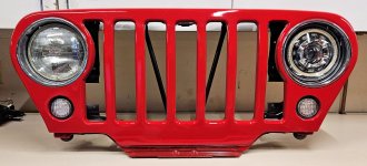

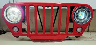

As a first test, I installed one in a TJ grille in the workshop to compare it to the stock sealed beam.
I powered both the LED and the sealed beam and my first impression is that the LED is a lot brighter than the sealed beam but I'll have to get it out on the road to verify that it improves visibility.
The headlight has a standard H4 plug on the back on a short cable sticking out of the headlight which matches the prongs on a sealed beam so the TJ's headlight plug will connect directly to it. The kit also includes a pair of H4-H13 adapters to use these headlights in a JK Wrangler. There are two extra spade connectors on the headlight cable, the white one is to illuminate the DRL (Daytime Running Light) halo function and the yellow one is for the turn signal halo. The DRL halo light is white and the turn signal halo is amber.
Next, using clip leads and a power supply I tested all of the functions of the light.

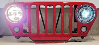

In this next photo, both headlights are illuminated in low beam. The LED side is deceptive in this view because it's a got a projector-style lens and unlike the sealed beam at right, not much light is wasted out the sides.
And both in high beam:

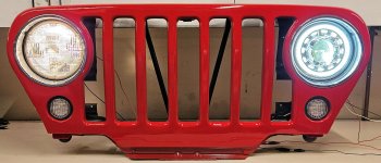

DRL halo:

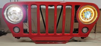

Turn signal halo:

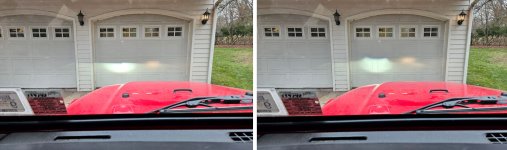

With the lights aimed at the garage door I took these next photos to compare the lights in daylight. The left photo is low beam, the right is high and on both photos the left headlight is the new LED and the right headlight is the factory sealed beam. The LED is much brighter.

After dark I did a quick drive around town to see how the extra brightness translated into extra visibility. These lights offer a significant improvement in nighttime visibility. The beams seem well-focused on the road, and no oncoming drivers flashed their lights at me to indicate that the lights were bothering them - the vertical cutoff of the beam is very well defined and below other driver's eyes. The new LED is only on the driver's side, the stock sealed beam is on the passenger side so things would be even brighter with these LEDs installed in both sides. This is low beam:
If you're not a fan of the DRL or turn signal halos, these lights may still be worth considering - the improvement in nighttime visibility from the projector headlights is excellent and you don't have to connect the halo functions if you don't want to use them.
