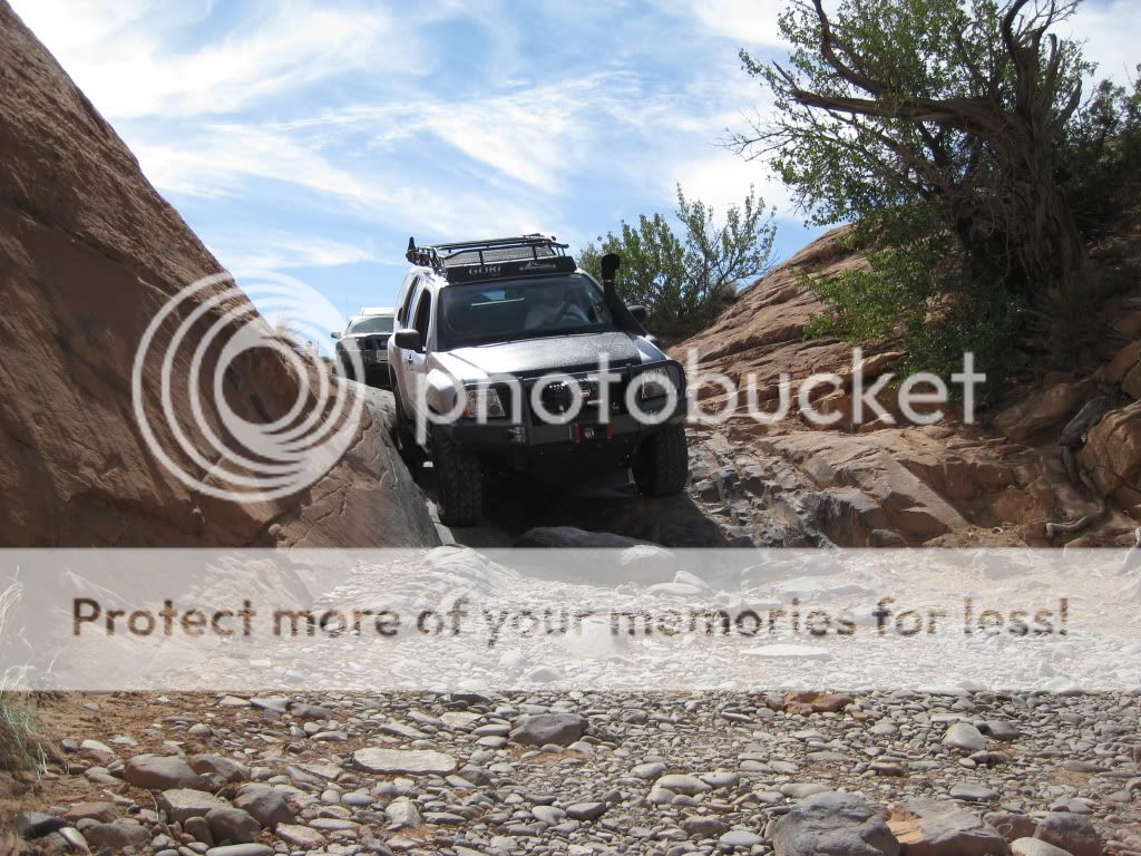

rig of chrishaynesusa
Rig of ChrisHaynesUSA Prepped for Deadhorse Alaska

The TITAN SWAP Project
chrishaynesusa Titan Swap (Bumpcans, Limit Straps, DirtKings OH MY!!) - Second Generation Nissan Xterra Forums (2005+)
Hood Mod Parts
ARB:..... Air compressor(on board air), air locker for the M226
PRG:.....Titan UCAs, steering rod extensions, .....Misc hardware for Titan swap, new rear shackle bolts
DIRT KING:..... Replacement LCAs,
SAW:..... coilovers w /ext reservoir
Superior:.....4:10 gears for the M205.....4:10 gears for the M226
A/C Parts .....2" Body Lift,
Cardone ....2 new Titan axles
Nissan : M226 Rear diff , M205 Rear diff, ABS for M226 and wiring harness
Shrock : M226 Diff cover
Ezaccessory :rear Wheel spacers
Radflo : 2.0" Non-Coil Shock w/ Remote Reservoir
Completed ReGear/Lock/35's Project
ARB:..... Air locker for the M205
Superior/RuggedRocks:.....4:56 gears for the M205/M226
OEM Titan Axles(new from Nissan)
Goodyear Wrangler: MT/R Kevlar 35 inch Tires
COMPLETED The NEXT NEXT Project
Re-Powder Coat Calmini bumper and modify for light guards and off road lights
Install InSain Fab rear corner panels and rear shock skids
Replace Stillen Metal Matrix pads front and rear
Install LED reverse lights
Install RCV Titan length half axles
The NEXT3 Project(INWORK)
Air Tank for air reservoir went new direction cancelled
Beadlocks on stock 16 inch Nissan wheels
Install ARB "RED" diff cover (DONE)
Install Rear Storage Drawer set(DONE) and mount ARB refrigerator slides (DONE)
Trailer build

Very impressive X.
I am jealous that Calmini makes that bumper for the X but not for the Frontier. I would love to have a PowerPlant.
mayoibushi
where did you get the jerrycan mount for the calmini bumper? expeditionexchange's jerry can roof rack attachment?
Wicked rig, what do your kids think of off-loading? Seems like an awesome way to bond; heres to hoping my kids enjoy it when they are older :)
Sometimes they like it, mostly when we finish for the day and the can play in the tent or have fun together.
during the days off road trail time they like to watch movies in the rear seat area.
I have monitors in each of the headrest and they can watch Japanese cartoons while I drive.
