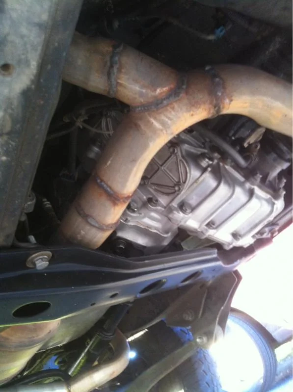

So anyways, I recently did a deal for a trade on another truck I have, in the swap I am getting a 1991 v8 FJ80. I don't have the truck yet so perhaps this thread is a bit premature. I am pretty excited though and the deal is done so figured I would post up on the truck!
If you are in the Land Cruiser know you have probably heard of Georg who owns Valley Hybrids out in California. He is a great guy, does awesome work and is strictly a Cruiserhead. He has been working on Cruisers for over 15yrs and is well known for his motor swaps and conversions, mostly v8's and diesels. Well, the truck I am getting is Georg's old shop truck or DD. So on with some specs and pictures!

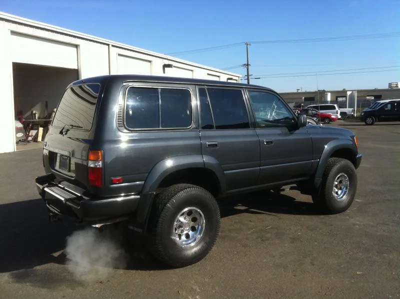

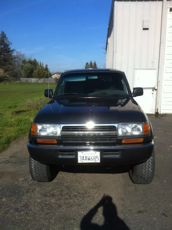

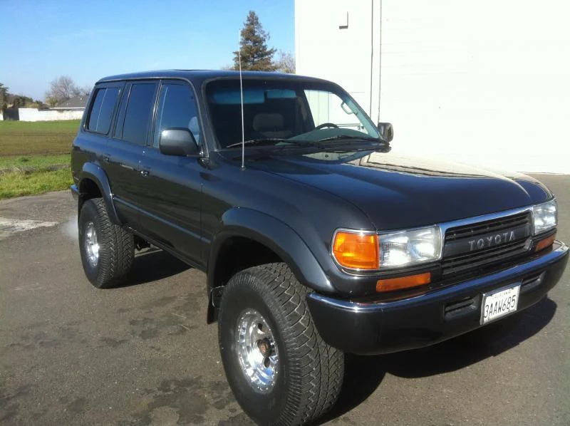

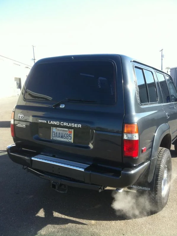

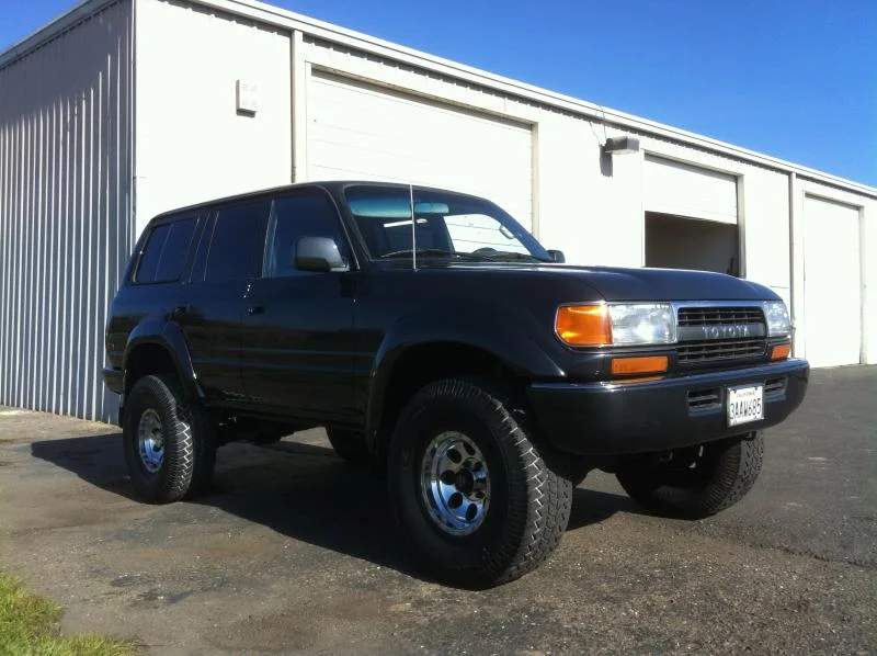

1991 FJ80

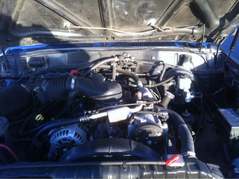

-Chevy L31 v8, 255hp & 330ftlbs
-4L60E auto trans
-FJ60 split case
-FZJ80 axles with e-lockers
-OME lift with 35" rubber
-part time 4wd with f/w FJ60 hubs on the front axle :)
The truck has cloth interior which I like. It has fresh dark grey paint which I also like a lot. It has had a lot of work done to it in the last 5yrs. New alternator, new dizzy/cap/wires/ect, rebuilt knuckles and new FZJ80 brakes, FJ60 free wheeling hubs, fresh rebuild on the split case, new windshield and tint on side glass, new alternator, A/C works and blows cold and much more! It is pretty stock otherwise with no bumpers or bar work.
I plan to simply use the truck for the next year or two while I build another project I have. I may do some things to it like some bumpers and bar work. I am not a fan of the wheels and tires so I will likely change those out too. I may put in some Procar seats but the stock ones are not trashed so who knows. I may put a fridge in the back and do a few small other things. For the most part though I plan to just use it and enjoy it.
Here are some pictures, these are Georg's pics....

I doubt I will need anymore power above what the L31 has but if I do it is cheap and easy to get some power out of the engine. Summit shopping spree!? :) As you can see it is a real clean truck and if you know Georg you know it is done up right and in tip top order. I am stoked!

By the way, that L31 is not TBI, it throttle body injected, (pic in above post) but is multi- point. That engine has the LT1 heads too.
Maybe the best non-LT1 and non LS engine to swap.
Enjoy.
RMP&O
Enjoy.
Sweet! I thought it may be multi-port but couldn't find much info on the engine doing some searches. That is a big bonus to me along with the LT1 heads.

why the fj60 case? no adapters for an fj80?
Part-time 4WD, gear driven case with low range options. The 80 case is full-time 4WD, while a part time kit is available, it costs about 3x the going rate of the 1980-1990 split case. The split-case is rock solid, lots of gents running them behind big blocks and various diesels, a huge upgrade from the one-piece case of 40's and 55's and on par with plus the part-time compared to the 80 Series cases. There are several different split-case varieties, generally the later the better but the latest version is vacuum 4WD operated, a plus for some, minus for others.
