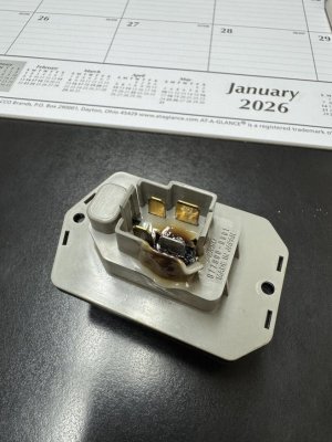

After that was done, I dropped the glovebox lid and started looking for HVAC issues. They were pretty easy to find...
A new resistor module and some harness repairs got me a working front blower. Heat is a nice thing to have...
The old resistor module-

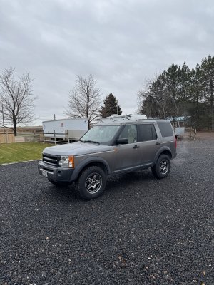

Today I replaced the air suspension with an Atlantic British Old Man Emu suspension kit with 2" of lift. I also went down to 18" wheels and up to 255/70 18s in load range D.
It looks, in my opinion, really good with the new shoes.
