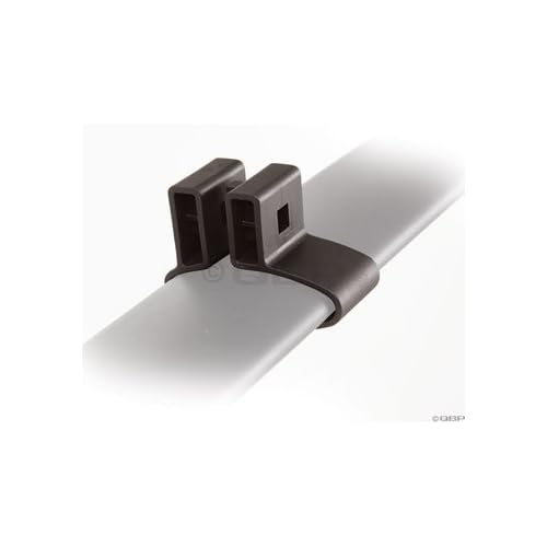

We sell these Tent Mounting Brackets for the very purpose. http://www.adventuretrailers.com/accessories.html#tentmount
They slide into the extrusion on the bottom of the Eezi Awn and then clamp around the cross bar.
Allows for easy fitment and removal, plus you can re position the tent.
These might work, and look heavy duty. Do you know what the distance is between the bolts? I will have to look at the rails on my tent too, to make sure I have the rails running the correct way.

The holes are 2" apart, we use 2" x 1/4 20 carriage bolt and nylock nuts.
We have the plates made for us out of 1/8" steel that is plated.
We developed them because the traditional method of mounting the tents was time consuming and difficult to move once you had the tent mounted. Using these brackets you can move the tent along the direction of the extrusion.
You need two brackets per cross member.
We use them on the Thule cross bars on the Chaser trailer, so we know they work with Thule system.

I really like these. They won't work for the Subaru though, as the rack is too narrow to get them lined up properly, and the railing is about 2.5" wide. I might order some for my Montero, as they will make life easier there, as I won't to be able to slide it along the bars if also loading the kayak.
