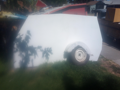

Can you answer me this ? Why would anyone build a trailer that can fall apart in 10 years? the main thing I see at the shops is older people get these crap trailers that fall apart . The older you get, the more it hurts to maintain are fix . The glue and go style of trailers. You go to Walmart to get what you need to fix, and no $250 book rate per hour at a shop.The person who builds these for us is 70 with one good arm . The last picture is so easy to build cap with no mold . Just 3 layers of 2'' straps of fiberglass . That you sand to look good . You start with 3 layers of clear packing tape on the pod so you can remove and have space for sealing

the pods for trailers run under $800 US in materials a $14.00 hard board for flat skin . by doing a 2-part layup you get a convex panel. The last lay up sinks a bit, that put it under load. The more you push, the more it pushes back .
