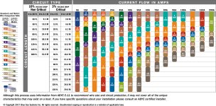

My 7 pin connector puts out about 5A, sometimes less. I’m certainly no expert, but I always keep this Blue Sea chart around when I’m doing 12V projects and try to stay in the 3% voltage drop zone, if possible.
6AWG should get you much better results. Good luck on your install.👍

Highway-that’s a pretty cool chart, makes it pretty simple. Thx
