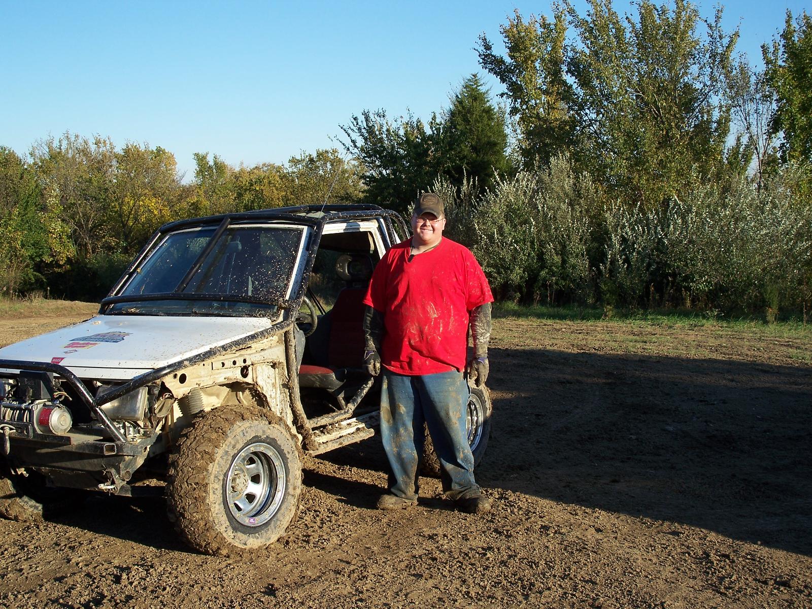

I'm really digging this one I found on Pirate
32X11.5 sx, stock drive drain, 3" body lict, 2" sus lift, bumpers, sliders, and skidplate
