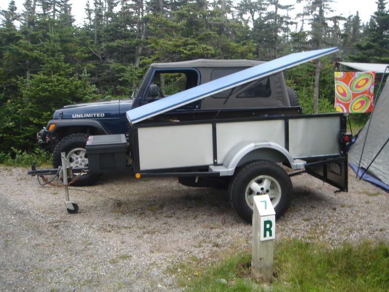

I guess that's good and bad news about the truck bed. Although building the bed may be more work, I don't think it would be a bad thing. It would still give the same functionality, and given your reputation, it shouldn't be anywhere near pushing your abilities. It would also give you the ability to design in some addition options that would have been harder working around the old bed design. But I'll try and not fill your head up with all of my stupid ideas.
I've seen your trailer thread...idea sharing is all good. :sombrero: I'm with you. It may open up some opportunities, but will just take longer to build. At least I should have a flatbed-ready trailer for the summer, and can continue to work on a box set-up for it while I use the "base trailer".
