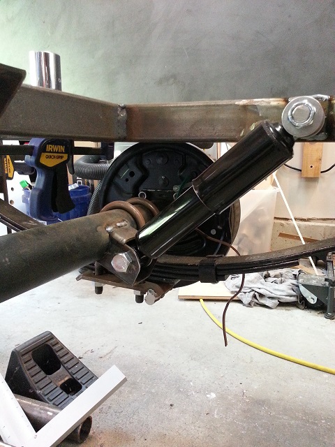

FWIW, here's how I welded my shock mounts onto the axle tube:
image.php
I used a piece of square tube with one end cut to match the axle diameter. The other end is cut and drilled to mount the shock absorber. The axle side of the shock absorber mount is welded along the top and bottom edges, parallel to the axle tube. There are no vertical welds connecting the shock absorber mount to the axle tube as these could create unwanted stresses.
