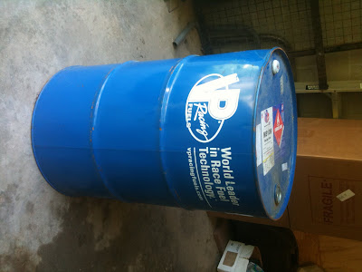

It's pretty easy really. Add a few breather holes in the bottom, a grill, and fire basket and start cooking. :D Here's some of the build:
Finally got started cause I'm ready to smoke some butts. I started with a VP racing fuel barrel that I got from a buddy.
I've read a ton of threads here, at thesmokering.com, bbqbrethren.com, the Texas BBQ Rub forums, and others and decided that a good donor grill would be the best source of parts. So I found this a Big Lots for $29.
It was a sealed barrel so I had to cut the lid off.
What did you use to cut the top so nicely? Cut off wheel?
MossMan
yep. except I goofed and cut the rounded lip off. you'd be better off to cut around the inside of the lid cutting downward and leave the lip. that way the lid will seal better.
