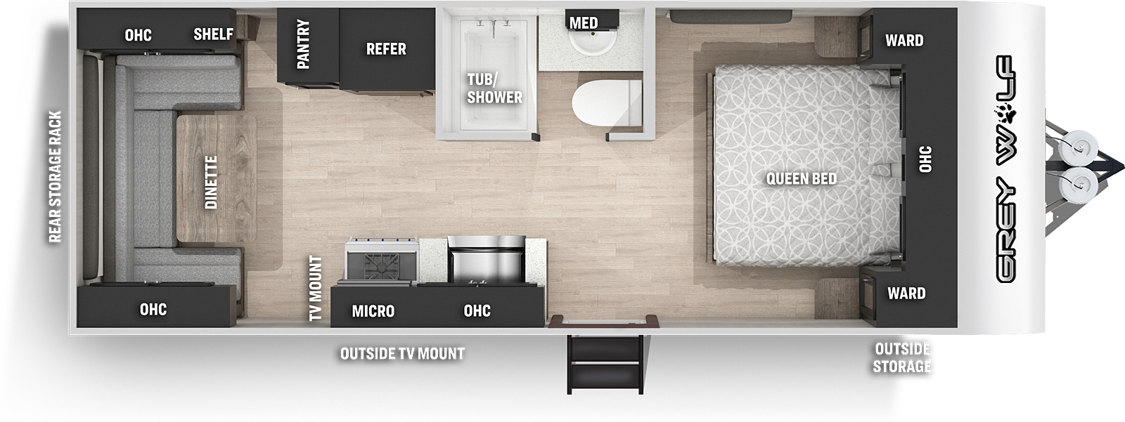

A small trailer, say 20-23 feet is easy to tow in small towns. I tow 20-23' utility trailers in big cities more often than I want to. And towing them to any actual place fun to go is cake. If you oversize your truck, F350 DRW, CC 4wd, it's even easier. Although a SRW truck is all that's needed with little trailers. DRW is always great for slide in campers.
Even a el cheapo single axle trailer is a mansion compared to a slide in. Even a big quality slide in like Lance.
Grey Wolf 20':
ImageHandler.ashx

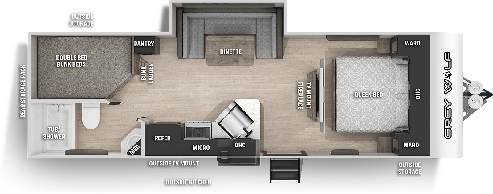

Grey Wolf 23'
ImageHandler.ashx
ImageHandler.ashx
