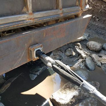

A few interesting pics from my recent Rubicon trip.
One is just a good reminder of how the SSRA device works. This was a simple winch connection when pulling a vehicle backwards after it had bellied out on a large boulder. I find myself using the winch more for recoveries like this lately since the recovering vehicle can just stay in the same position. No need to worry about if you are going to be trying to climb your own rocks while trying to use a strap/rope. It is also easier to provide some off center pulling if needed to shift the vehicle over. Doing the same thing with a longer strap is always a pain on tight trails.

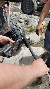

The group also ended up using an SSRA as an 'off book' edge guard while straightening a sway bar arm after an upper link failed causing everything to shift hard to one side. It is nice to see people taking active steps to protect soft rigging in weird applications (without me having to remind them!). I think a lot of people tend to view soft rigging as fairly disposable, and while it is more durable than most people think, it is amazing how long it will last when properly protected from hard edges.
