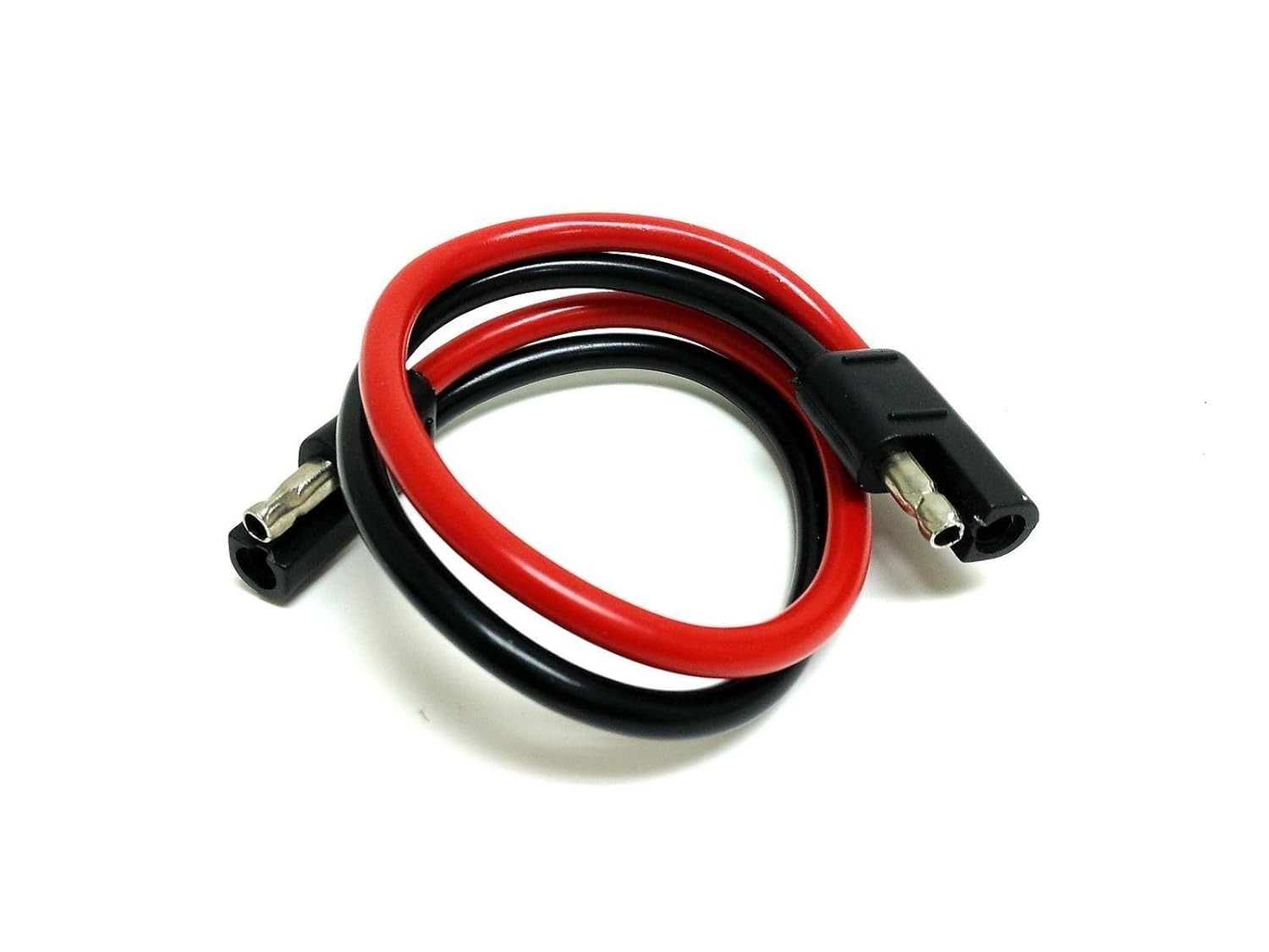

A question though: why the switch inside? I'm kinda paranoid and always wanna have an easily accessed power off switch, but that may be overkill here. Also, I've found those solar type connectors (forgot their name) kinda difficult to use on my panel; I am going to switch them out to powerpoles. And what did you do about fuses? maybe I missed that.

A question though: why the switch inside? I'm kinda paranoid and always wanna have an easily accessed power off switch, but that may be overkill here. Also, I've found those solar type connectors (forgot their name) kinda difficult to use on my panel; I am going to switch them out to power poles.
I put the switch (and everything else) inside for durability. I run it with the cover off (eliminating the need for power using fans) so I can get to the master shutoff switch as fast as if it was on the outside. As for Power Poles they do make things much easier to connect/disconnect. I went with these:
http://www.amazon.com/gp/product/B0057ZQJ12/ref=ox_sc_act_title_2?ie=UTF8&psc=1&smid=A1IBW2HULNJLEY
