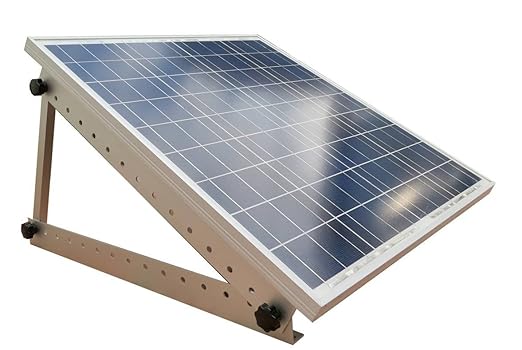

It seems that if you want the best of all 3, a set of these AM Solar mounts would work fine. They're more expensive than the plain Z bracket mounts but should give you a solid flat mount, as well as the ability to tilt if needed and remove for cleaning or remote collection. I would think you could keep a coil of extension line for those times when you want to park in the shade and collect in the sun. The rest of the time it's out of sight and mind.
akin to the above. A system like this could be rigged so the pivot can be reversed and the panel tilted in the opposite direction. Especialyl with those sort of knobbed bolts.
https://www.amazon.com/Adjustable-Solar-Panel-Mounting-Bracket/dp/B00SBCKLYO
Personally, I'd want it stored flat on the roof. In a suitcase, it'd rarely make it out of storage... unless I was going to be parked somewhere for at least 24 hrs. Tilt and portability would be nice, but KISS is also a real bonus.

I had my 200w mounted on the Amazon tilting system and it was great for long stays but it added 3 in hight and lost the stealth look... I went back to flat mounted and don't really think about them much. Sure the angled panels harvested more power, especially in the later part of the day but I'm going to add just one more 100w panel for quick deployment in the near future for when needed.
