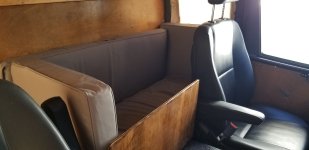

  • Interior cab is coated in sanded plywood stained Varanthane Early American then clear coated front and back
  • Pet area behind driver side and center area installed. ~60Ibs dog was comfortable in this area.
