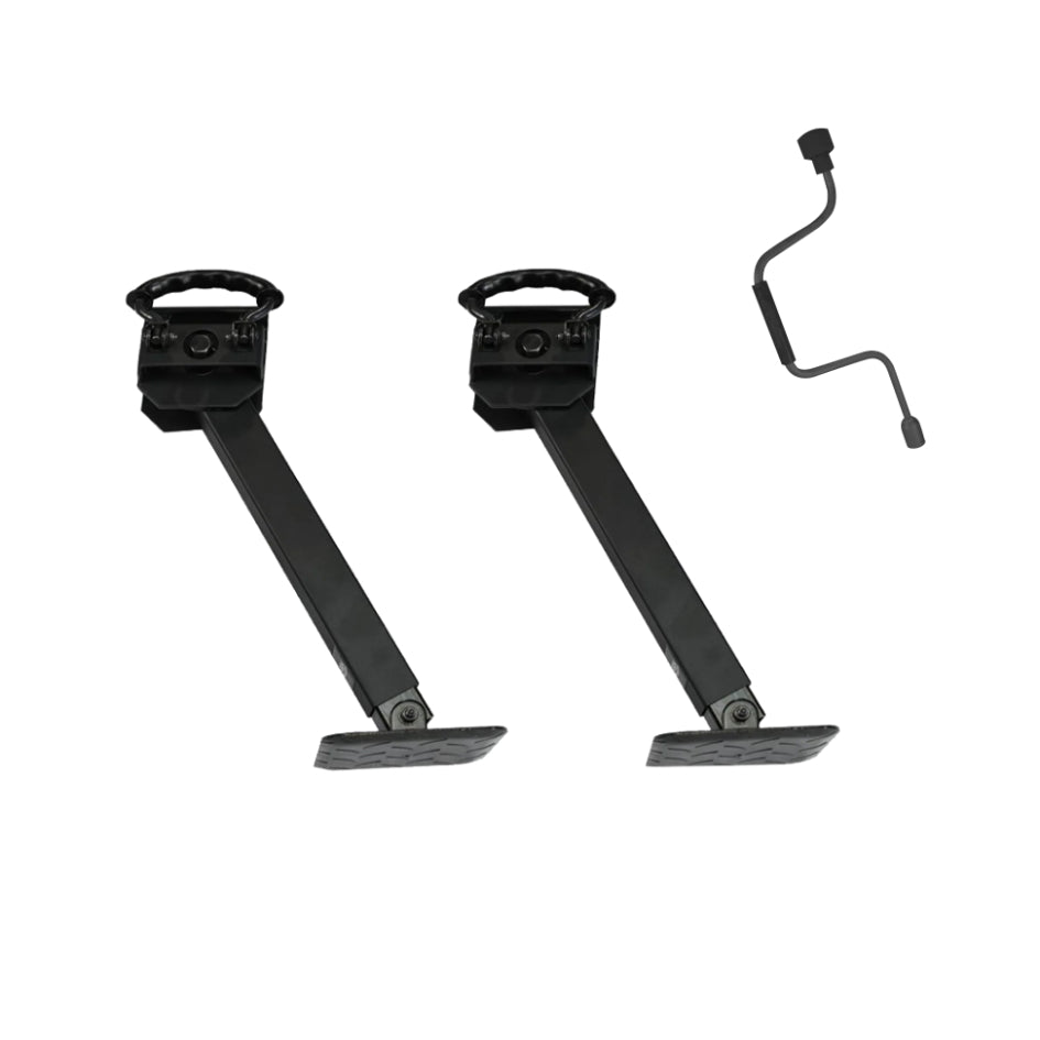

We went with detachable tongue crank jacks (no clue if that the technical name LoL) one on each rear corner and one on tongue. I typical leave the wheels on the ground 35x12.50s no brakes. No issues. Pic was w no wheels but ya get the idea
If all you need is stabilization to prevent rocking, etc. and not self-jacking, something like this would be much lighter and cheaper:
Heck, this is even a DIY candidate if you're moderately handy and are the kind of person likely to carry a ratchet-strap anyhow.
