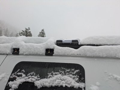

I recently flat mounted (to the roof rack) the Striker Mount for Starlink Mini with the polycarbonate shield (SKU:MNT-0201). It's built rock solid. I previously tried another manufacturer's quick release mount and it didn't hold well after a few miles of washboarding; didn't like having to routinely check if the "cam style" locks had popped open.
