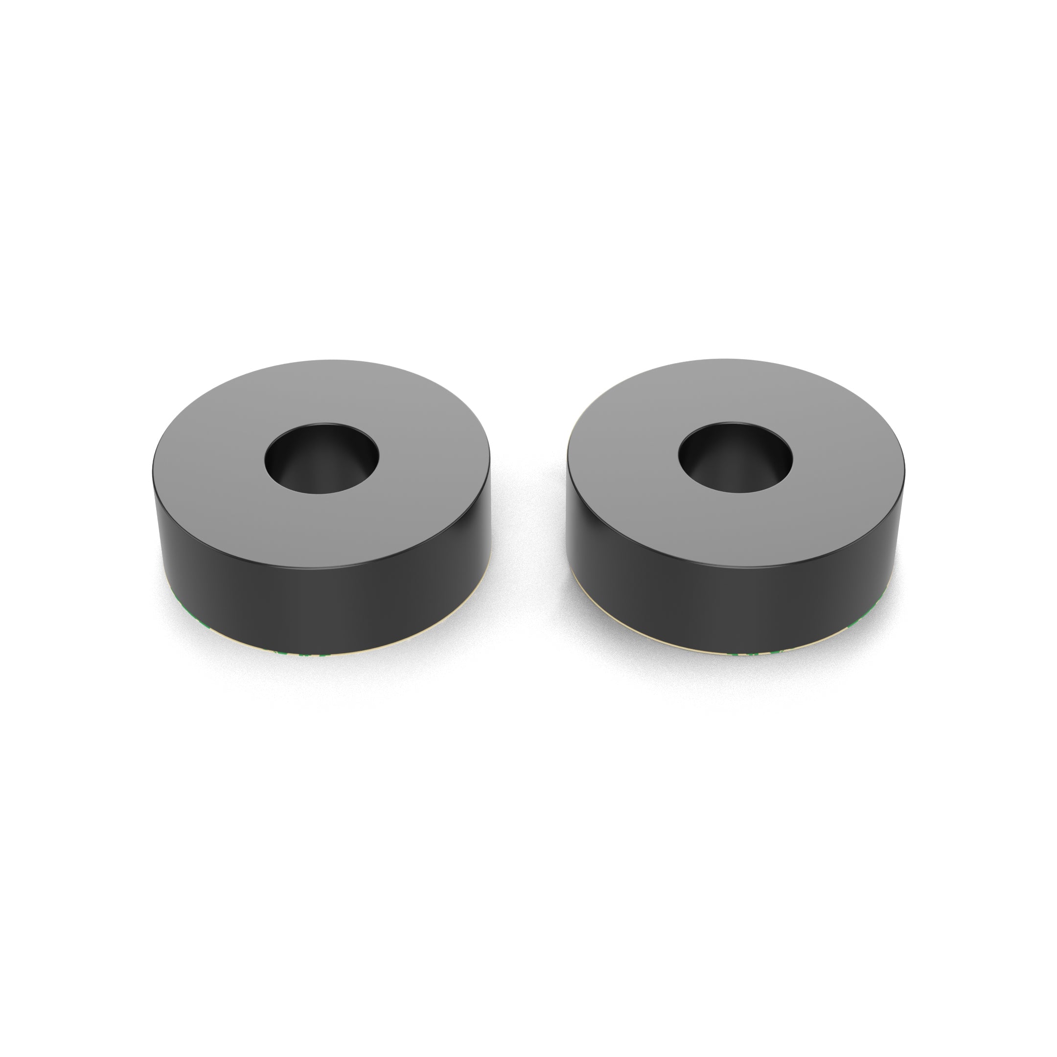

oops; sorry if i was not clear. the box will be wood & isolated from the frame w/ 70 durometer rubber (sheets/ washers/ bushings)

i want to build the box from wood because i understand how it works & is done, but have no metal working skills.
