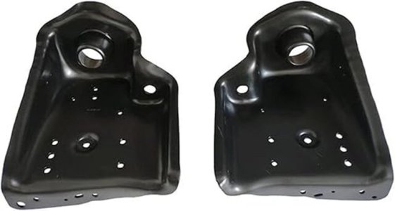

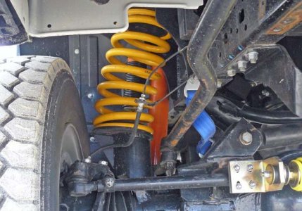

Front suspension? This is where my ideas go a little left of center. Regardless of cost, and because of the inherent ride qualities of a cab over engine design, why have others not swapped to a coil spring set-up like a Ford F550? Lower control arms to keep the axle from twisting and a Panhard bar to locate it left to right. Spring buckets are available or could be custom made along with lower coil seats. A few brackets welded onto the axle and frame for the control arms, Panhard bar and shocks. Seems the ride with coils would be much better. I built up an FZJ80 Landcruiser with this very same suspension design, so that is kind of where I am getting my ideas from. fts22384-kit.jpgSOF1094-1.jpg51uwt2S95-L._AC_SL500_.jpg

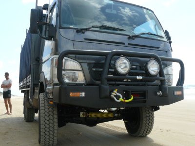

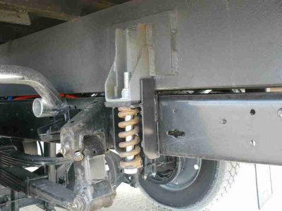

Starting around 2010, All Terrain Warriors here in Australia did a 5 link coil conversions with a Watts link at the rear to about a dozen Canters , of which my truck was one.
I have driven (or been in) numerous different Canters that have had suspension modifications done, but none have really equaled the ride quality of my truck.

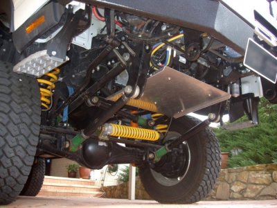

I wonder why the radius arms are mounted forward and not rearward like on say a Ford or landcruiser 80 Series? Was it because going forward had more space to mount the arms to the front frame? I was just thinking a radius arm design with Panhard bar would be a simpler design than say a 3, 4 or even a 5-link. Yes, the 3-link is a little bit more limited in how much they can articulate, but that isn't what my Fuso will be built for. I think I would leave the rear on leaf springs, just go with a softer spring rate than stock and coils in the front for better ride quality. Something to think about.
The first two trucks ATW converted to coils had leading arms at the front. From what I was told, they had bad bump steer, so the design was changed to trailing arms.
Over the years there were a few other tweaks for this setup, all of which have been made to my truck.

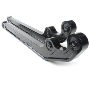

Seems like a great place to get any brackets and joints needed.

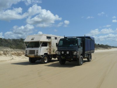

Was it you?
I don't know whose truck that is. It's not mine.
I got mine in early 2011.
I did not know that ATW did any half and half conversion, as this truck seems to have coils at the front and leafs on the rear.
Maybe they did more than two trucks with leading arms at the front. :unsure:
My vehicle is an OKA, a unique, Australian made vehicle that was designed and built from the ground up as a high mobility 4WD, rather than a 2WD light truck converted to 4WD as the Japanese vehicles are.
